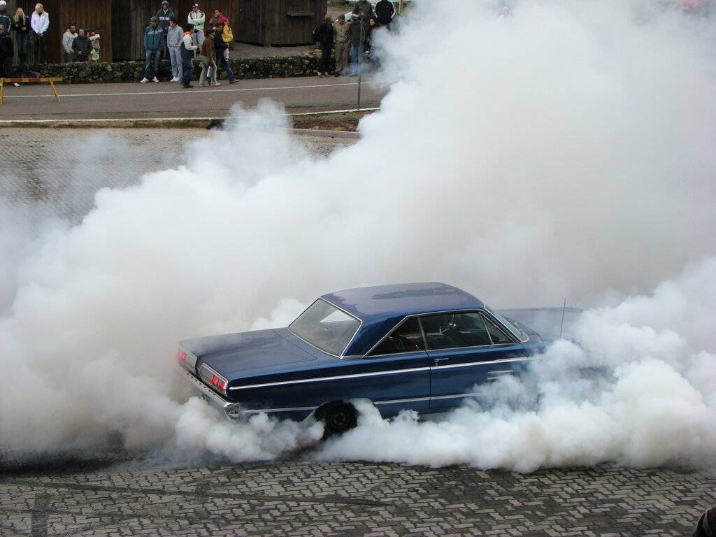

You can try a proportioning valve that allow to block the brake fluid to the rear whells... I did it in the past, many times. 2,76 gears, open.

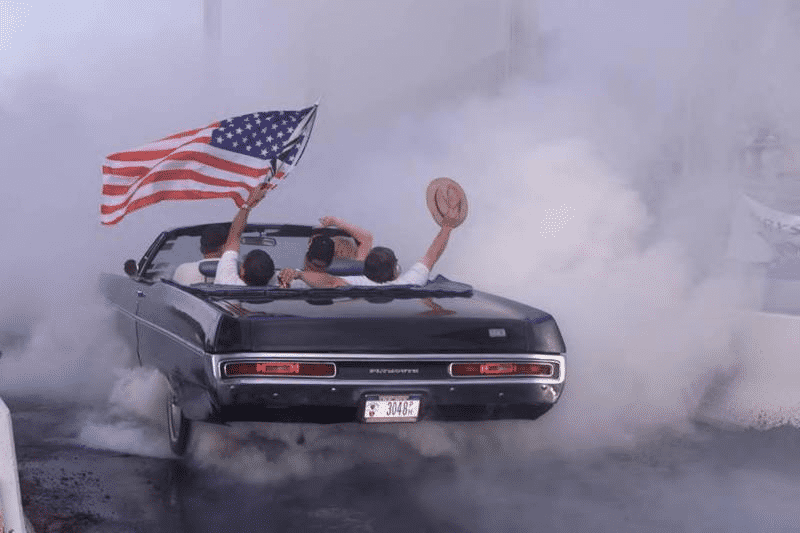

All of the above, but it's really about the ease of use. Really easy to get the tires turning with the front brakes locked and more control as tires break loose because the car is sitting still.
We used it back when we were racing... Lock the fronts up and start in second (manual shift automatic) then immediately shift to third. Of course, we were looking to heat the slicks and not put on a show, so the throttle was eased off when the line lock was released. Then a dry chirp or two and stage.
The Fury in the pic was using a line lock to hold the car (this was in Carlisle when they had contests) as they required a stationary burnout. My buddy Bruce owned the car at the time.

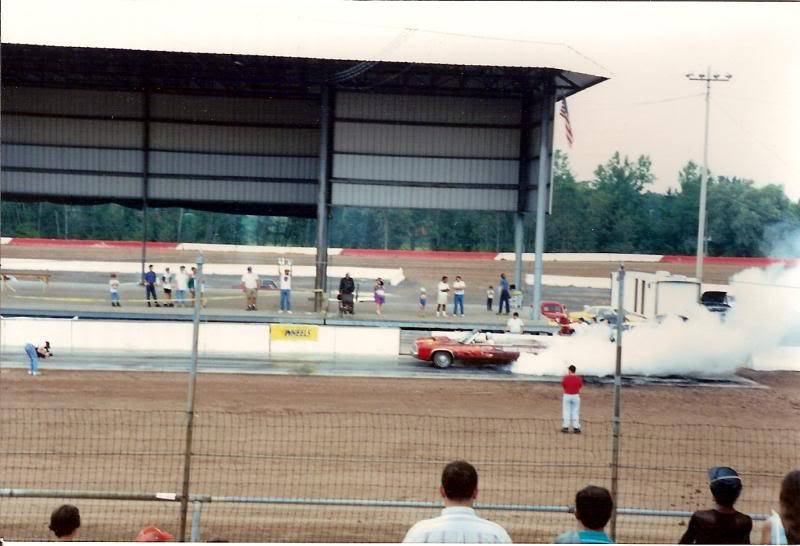

This car (below) also was line lock equipped and was done for a local contest using a junk Chrysler at least 30 years ago. Yea, I'm behind the wheel. We didn't win... Long story... We should have, but the "fix" was in.
