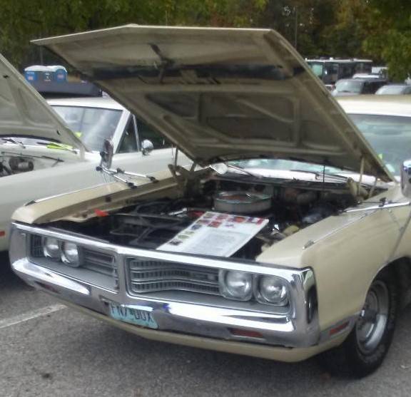

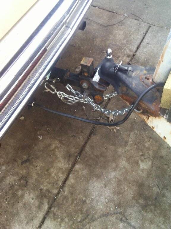

$428.99 u wil need valves springs good for a .500 " lift cam .i have this in my 1972 new yorker it has a 72 440 rebuilt to 1971 specs here r a couple of pics of the car & the motor
Stubbs, where are any pictures of your car? I would like to see it.
@shaun65Polara where in Minnesota are you? I'm at the bottom of the state. Wow is all I have to say about the engine compartment, didn't expect that from the profile view! I like **** being wrong for all the right reasons, so you're good in my book. Looks like you enjoy the car and drive it often. A big Hell Yeah to that!
