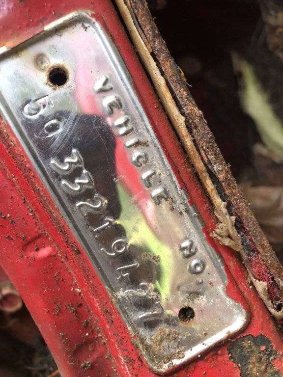

From the codes on serial number tag and fender tag that Dodge Custom 880 is most likely a police car
Here’s info on decode:
Serial number tag 59 33219427
5= Dodge Custom 880
9= police car
3= 1963 model year
3= assembly plant Jefferson
Last 6 digits = 219427 car built
Fender Tag
Body 593 decodes SAME as above
paint code most likely is “999” the last digit not readable since tag is rusted away.
999 = special order color
There is NO way to know for certain the exact color as mopar coded any non-standard color with 999.

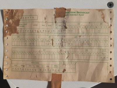

As stated during the earlier production years the fender tags were not standardized between plants. Where each code was placed on the fender tag varied by plant. Different plants placed the same code different places on the tag.
Some placed only one digit under the “A” and others used a 2 digit code under the “AB”. Though, Not all plants placed the code for engine under the "A".
In addition it was common practice that the standard engine was NOT coded on the tag. Only optional engines were. What letter was used to indicate the optional engine also varied from plant to plant.
So depending on the make and model, the engine may not be coded on the tag.
That being stated based on only having a digit under the “A” being 2, believe that indicates 727 automatic transmission.
To help you locate the buildsheet.
Here’s an example of the earlier style buildsheets. The codes are just alpha-numeric with limited sections having a header / info.
This is a 1963 buildsheet from the St. Louis plant. So again where & what codes were used would be specific to that plant and may or not be the same as other plants.
