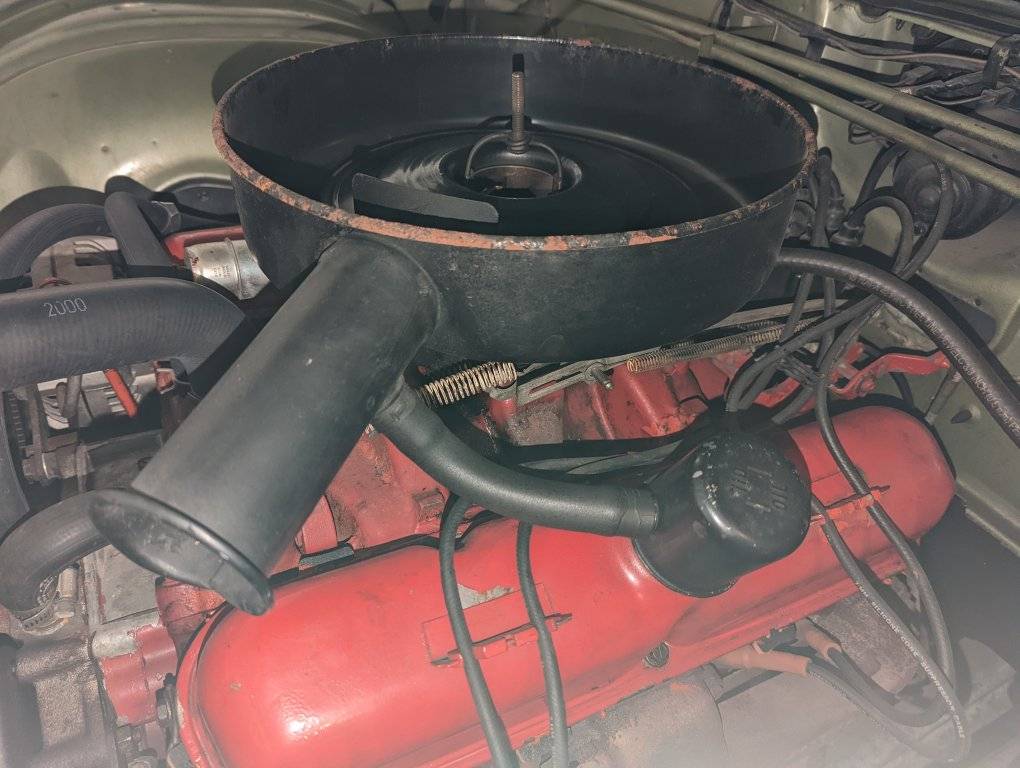

Sorry All, a couple rudimentary questions that I can't seem to find answers to anywhere else via Google, YouTube, or service manual.
- I have the 68 318 and would like to swap the air cleaner to a round style without the snorkel, but I see that there's a breather tube to the oil filler cap. If I remove this and replace it with a regular cap am I going to kill/overheat something? I see others with this setup and am not sure how they do it.

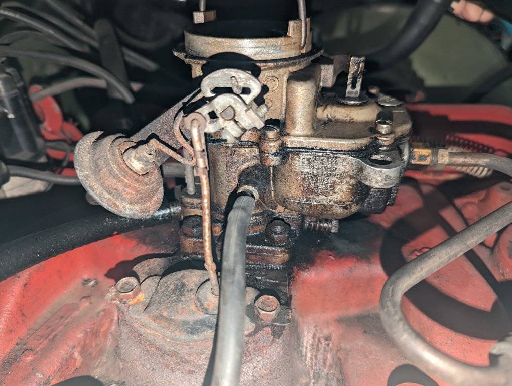

- According to the stamping I have a 2bbl Carter carburetor that needs work and I'd like (my mechanic) to replace with a new one (so I can tinker with and learn from the old one). I see that Weber and Edelbrock apparently still make these but can't find a direct replacement. Does anyone know where I can find an exact part number from them?

You can just let it breath to the atmosphere. You may get a smell through the vents on a hard pull (reason they vented to air cleaner)
PCV system draws out oil smoke and vapors at high vacuum. When throttle position allows for no vacuum the breather takes over venting excess pressure and vapors.

Those Carter carbs are good pieces. Have your mechanic rebuild that one.
Be wary of where new "Carter" 2 barrels meant for LA block Mopars are made! I've seen plenty chinesium knockoffs of those on ePay and other websites. They can be had for ~$80-90 usually, just like their knockoff Autolite 2 barrel copies.
Weber and Edelbrock ONLY do the AFB and AVS series of formerly-Carter carbs. Have NOT seen anything about them doing BBD 2bbls, or have I missed something.

The Carter BBD 2bbl is a very simple and easy to rebuild carb. A good design, too!

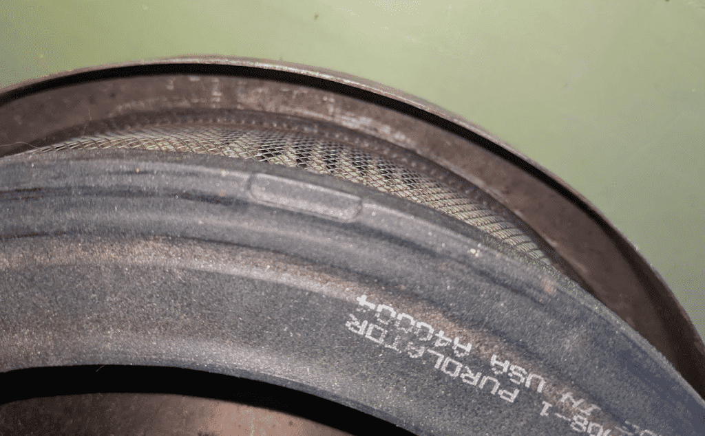

Hello! Nope, I gave up on that and chucked the new filter, etc. back in it's box on the rack of shame since I already cut on it. There isn't anything for one to sit on without touching stuff other than the very narrow neck of the throat so even my adapter is useless. Plus the indent around the bottom of the stock one to clear the rest of the hardware.

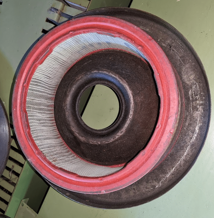

What we'd need to determine is if the 6cyl base (3rd pic) works for your car - I believe it will fit the carb neck, the concern is if it fits around the linkage, etc.
Then we need to figure out how to get more airflow between it and the top cover - the 4-barrel base used on the bigblocks has a bigger gap around the edge than the 6 cyl version.
But you have a 318-2V, so not as big a concern.
The 6cyl base actually fits 2 different diameters of air filter.
Here's the 6 cyl base vs the 4-barrel base:
Some holes/slots drilled around in this area would likely allow enough air to go thru.
Or could drill even larger holes if using this even-smaller 6cyl air filter. But I dunno if that filter flows enough for a 318.
For me, I would but smaller/more holes in with the larger filter.
Think about it - if the top lid give the look you'd want.
If so, we'll figure out some measurements if the base will fit, and then if the lid fits underhood.
IF so - we'll proceed from there.

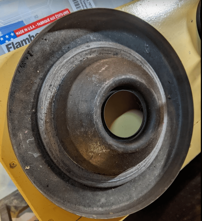

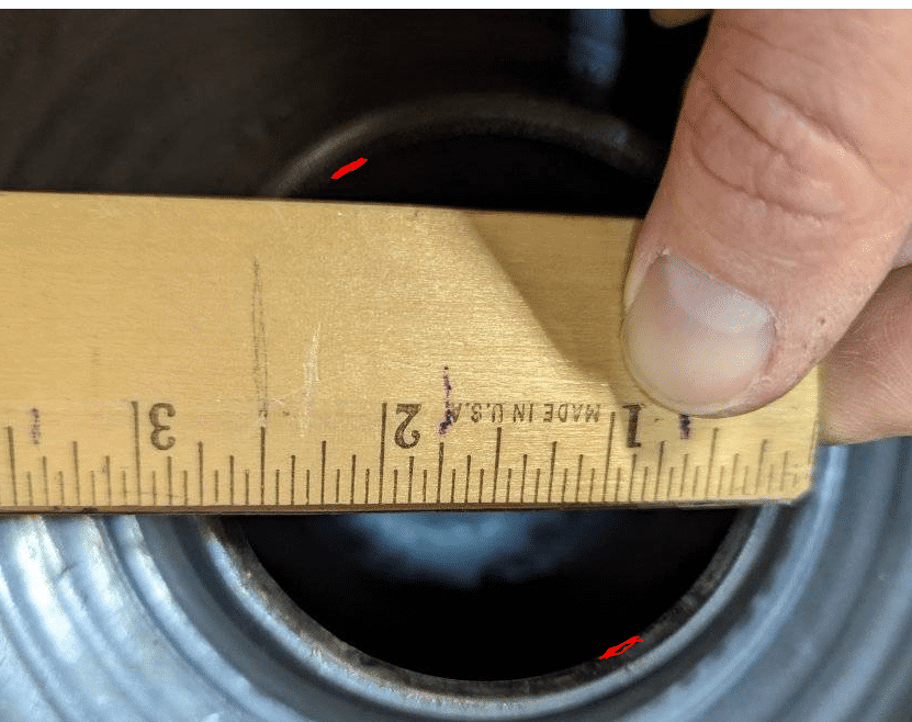

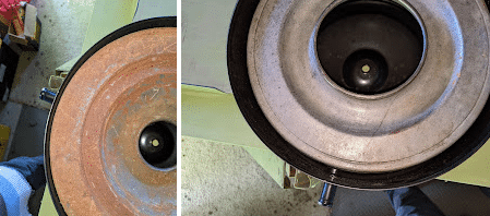

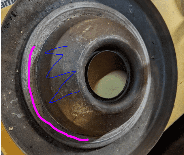

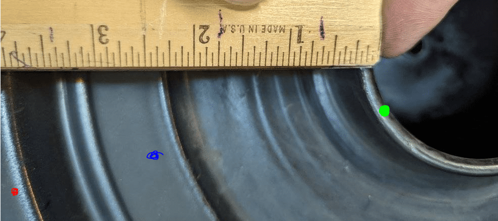

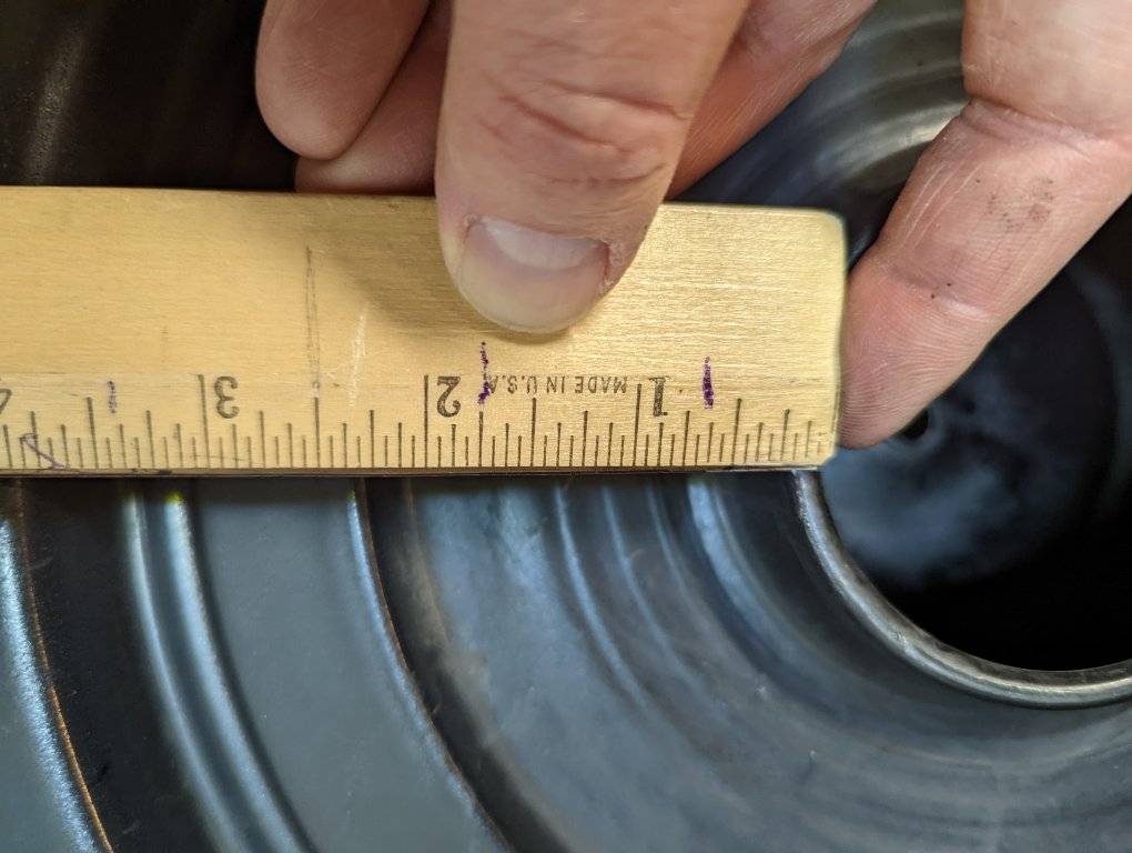

Here are a few measurements from the existing one, 2nd pic is interior, 3rd is the exterior/underneath gap for the other hardware clearance.

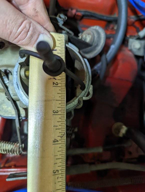

I measured a little differently, measured the ID of the aircleaner where the carb throat is - it's approx 2.3" (diametrically ala the red marks).
Below, measuring depth from the red surface (the bottom of the baseplate) to the carb mounting surface (lime green) is 1.56" deep.
Measuring from the red surface to filter mounting surface (blue dot) is .28" deep
I'm 99% sure this will fit teh carb neck.
I think the question is how does the height of this cone (blue squiggle) differ from yours, or more importantly, even if it is different, how does it fit on your carb regarding linkage, etc?

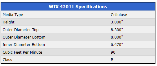

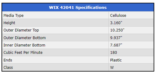

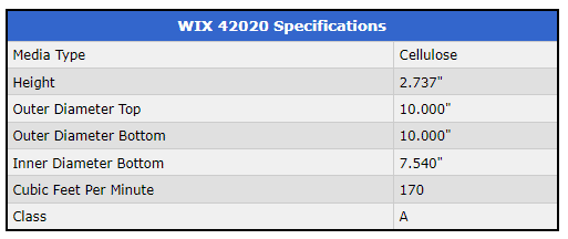

Next question is on the air filter. IIRC CFM x 2 is roughly equal to hp supported.
Here's the specs on the smaller red filter shown above in post #12, for 68 Fury cyl. (fits on the magenta arc above)
Here's the spec for the larger filter used on 383HP and 413HP engines, used with a 4-barrel base (which gives a larger gap between the lid).

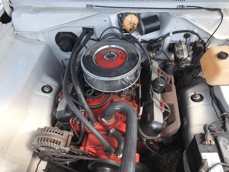

And here's 1980 Dodge Diplomat with 318.

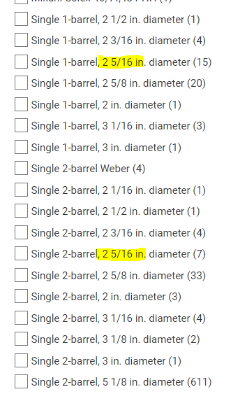

Teh cool thing is the lid will fit either the 6cyl or the 2 different V8 filters. I looked on Summit and it shows a lot of carb neck sizes. Shows 2-5/16" (the 2.3" I referenced earlier) as common between 1 and 2-barrel - but also 2-5/8". If the cyl base doesn't fit, maybe there's an aftermarket chrome base that could be used.
I did a lot of typing and pasting, LMK what you think.

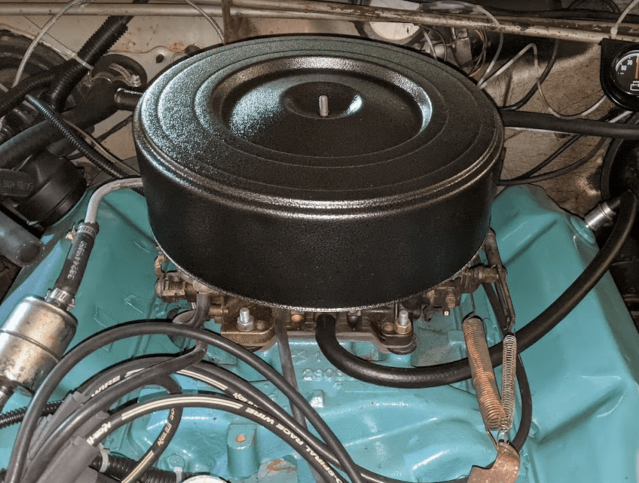

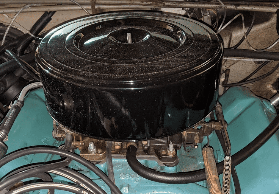

This is kinda the look I was thinking, but with your red VCs and one of my lids.
