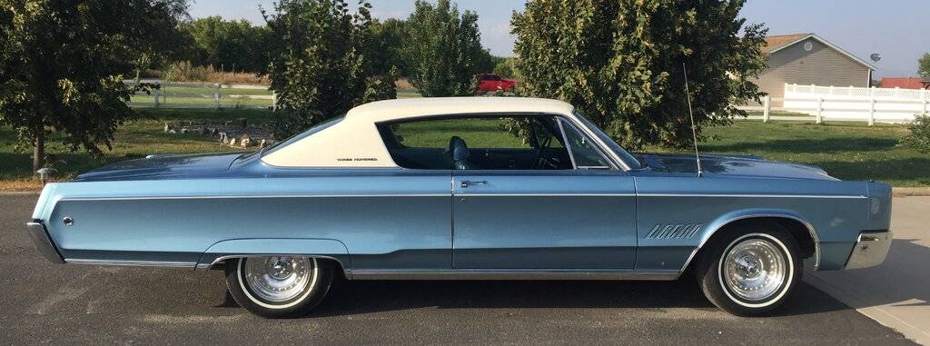

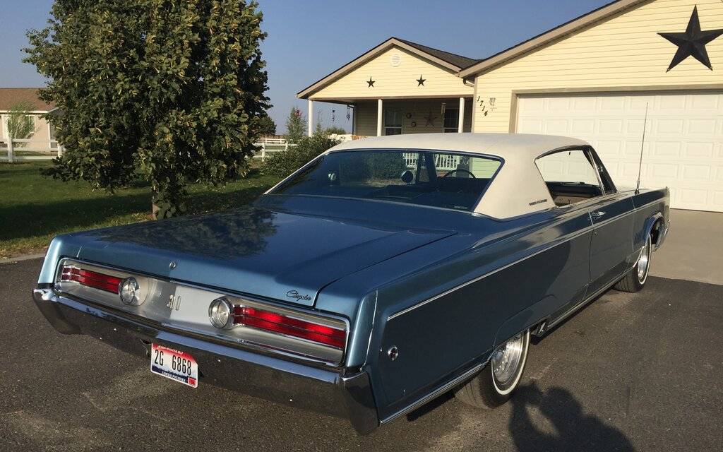

Edelbrock 1406 in place and tuned, kick down linkage adjusted and 60 mile shake down cruise completed. I’m happy to inform you that all is well with my ‘68 300, and the engine performs just as I hoped. Thanks for all the feedback, now onward for the dual exhaust installation
