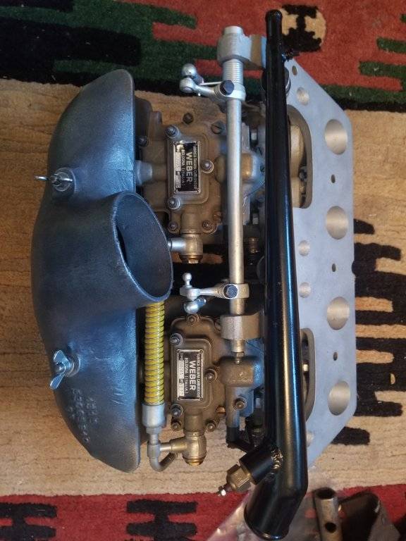

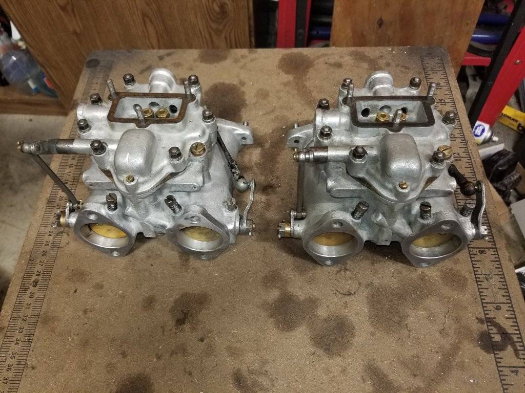

Thanks for the carburetor information. But I will try rebuilding the AVS myself. Done a few carbs over the yrs, mostly vintage European carbs, such as weber. Recently restored a pair of weber 40 DCO 3s for a 1960 alta romeo giulietta spider veloce.
The customers spider had the classic problem associated with ethanol blended fuels. The ethanol attracts moisture and the moisture clogged the small passages in one of the carbs. It took extensive work to clean the passages.
Several octane boosters use alchohol to boost octane. However a few use MMT. I will try this first. If it doesnt work I can purchase high octane fuel at exorbitant prices.
Heres some pics of recent weber restorations. Worked on other types as well. Recently rebuilt a cantankerous solex for an alfa (French thing that has no business being associated with any classic.)

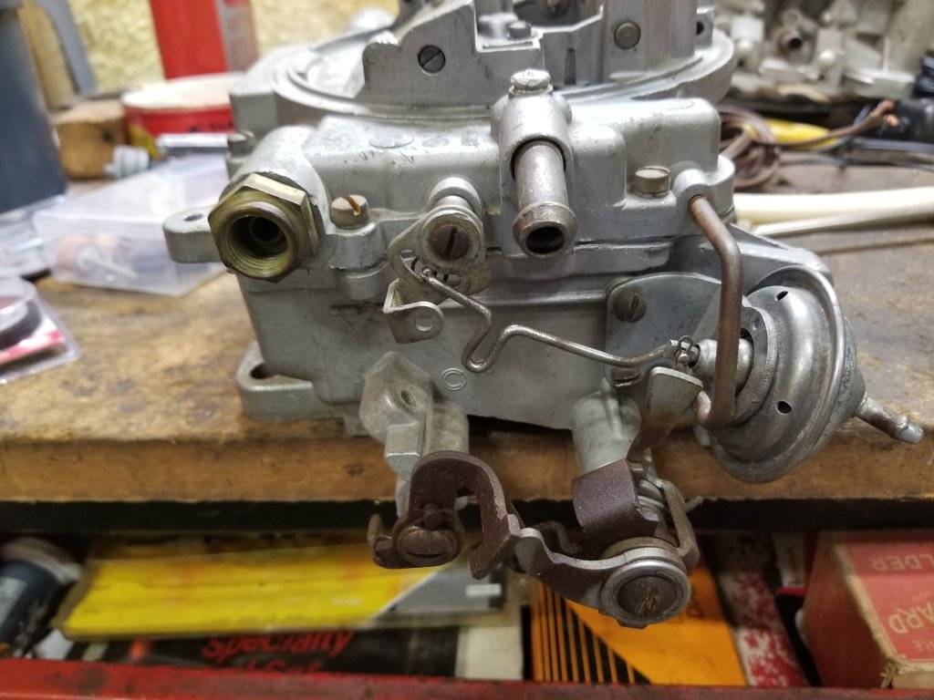

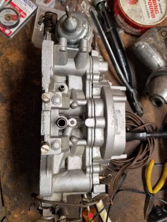

The carb was purchased off of ebay many yrs ago. I plan to rebuild it and check the jetting while at it. Hopefully all is well with it. 71 was a transition yr for emissions which incld carbs and ignition changes. Will attempt to sort things out when back together.
That carb has definitely been monkeyed with, and by someone who thought it not important to save both the idle solenoid and the bracket, etc, that hold it to the carb. If you plan on using it the way it was originally intended, you need to find those parts for it.
It was missing more than those parts. Slowly been gathering the remaining parts through the purchase of other derelict carbs.
4968S is a very expensive carb today.

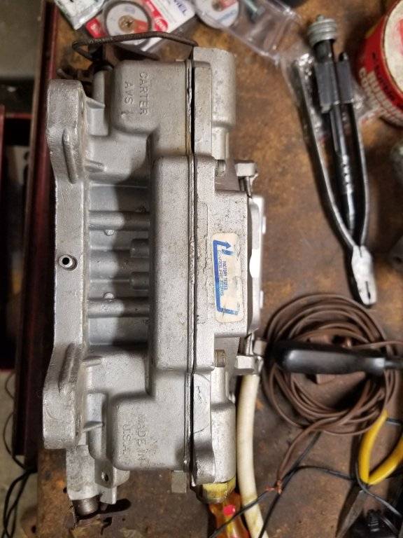

Unlike most Carter carburetors made for Chrysler(they were overwhelmingly a one year only carb), this one continued to be produced until at least 1977. It was obviously deemed a replacement carb for a lot of others. The same happened for the Carter 4640S, it became a replacement for most A/C carbs, and was made for about eight ears after it first appeared in 1969.
Yours should have its original pink coloured triangular aluminum tag on it, with the carb. number and date code on it.
Most of the used 4968 carbs you will see for sale are dated years after the original ones came on 1971 model year cars.

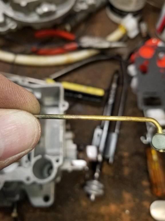

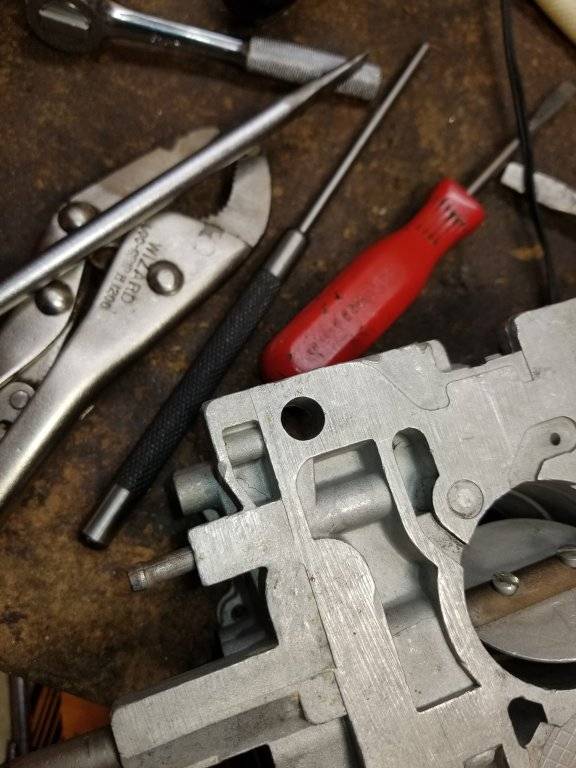

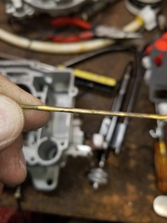

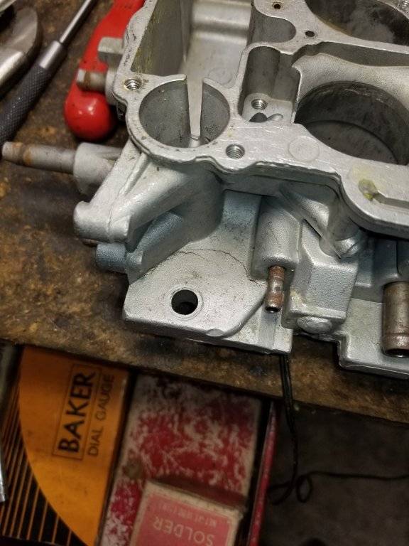

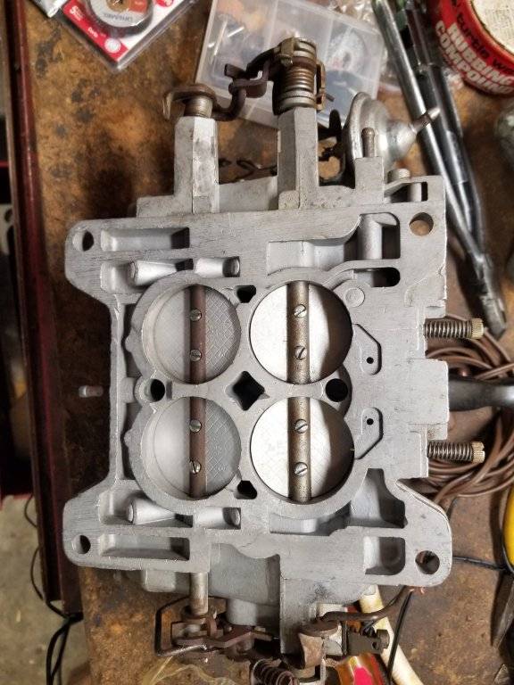

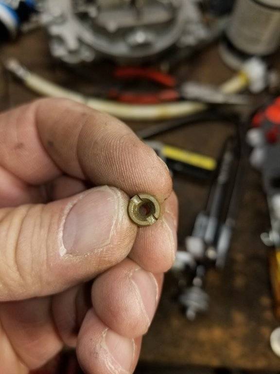

Disassembled and inspected the carter AVS. The only problem discovered was a hairline crack with one of the attachment pads. From other carter AVS carbs I've seen, this is a common problem. Doesnt seem to be critical. The main and secondary jets are not marked. The metering rods are as follows: 16-546. See pics.
The crack you reference is NOT a design flaw of Carter AVS carbs, it is caused by "user error". How do I know this? Because I cracked the base of my 4732S AVS when using a Mr. Gasket "gasket stack" heat insulator base gasket rather than the OEM-spec thick base gasket with plastic inserts in the hold down holes.
Yes, I was trying to help a "hot restart" issue with that allegedly better gasket, BUT I was also being careful to not over-torque the hold down nuts, too. Especially as the softer gaskets in the mix, between the aluminum sheets, were quite soft. I had it all nicely done, until that last little bit of torque and than faint crack sound. Everything seemed to work ok, but I did not want things to get worse, so I ordered up a new 4734S replacement AVS. Put a new OEM-spec base gasket insulator with it.
The meterinrg rod number sounds about right, but the jets sometimes are stamped on their sides rather than on the top edges. For good measure, you might fill those cracks with some sort of aluminum-like epoxy item (i.e., JBWeld for aluminum).
Just some thoughts and experiences,
CBODY67
Didn't mean to imply it's a design flaw. But rather someone over torquing the nut. Might be a good idea to torque the nuts in some type of sequence and a little bit at a time. Will put type of epoxy on the crack.
