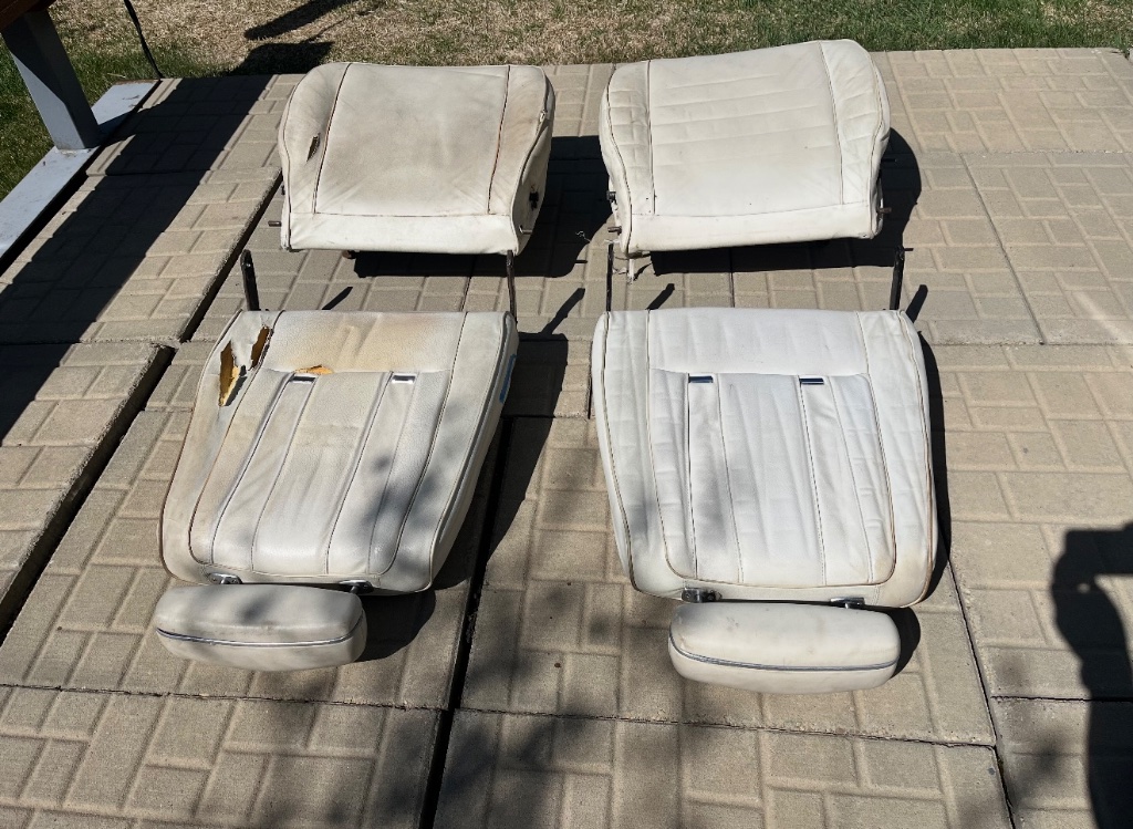

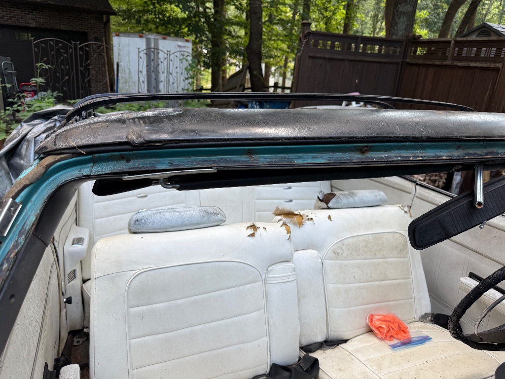

Does anyone know where I can get a center console for my 1969 Fury III. When I bought it, it had seats from a 1977 Chrysler New Yorker in it. Is recently purchased a set of original 1969 power bucket seats, but need a center console. Thanks in advance for your recommendations.
