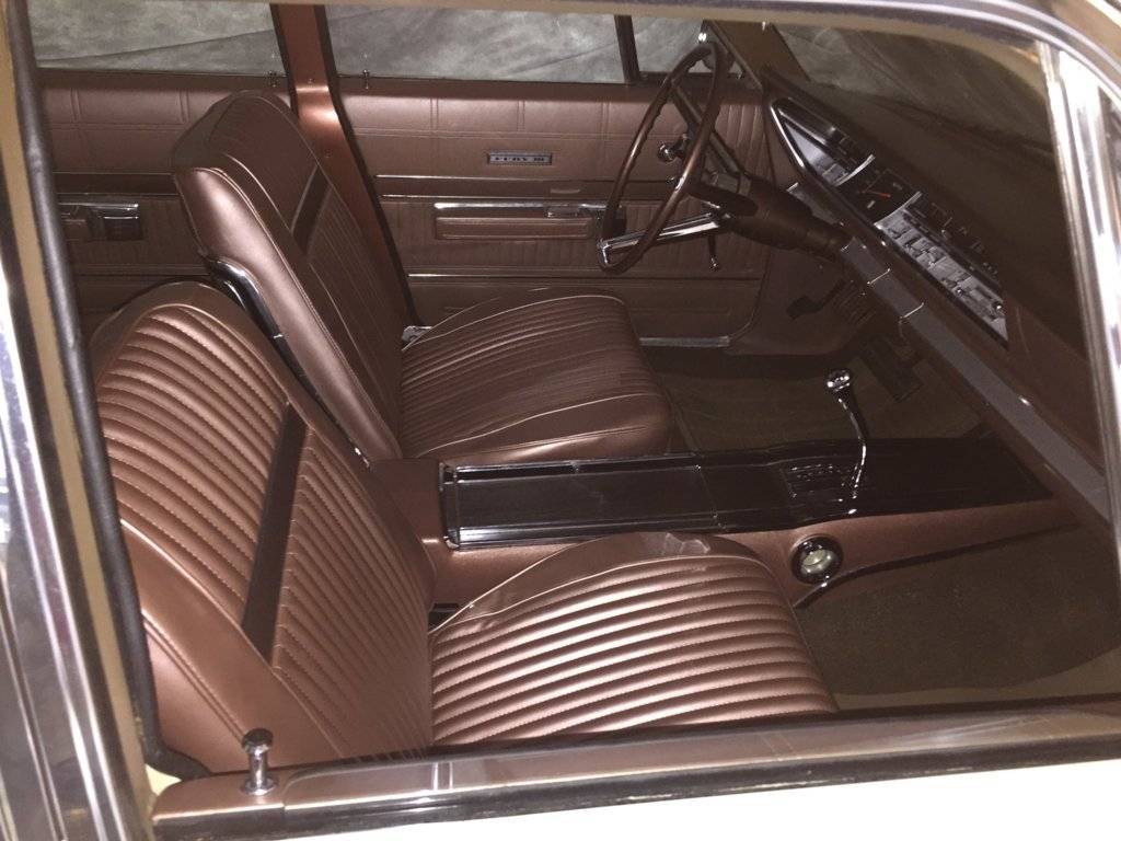

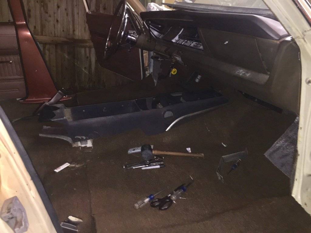

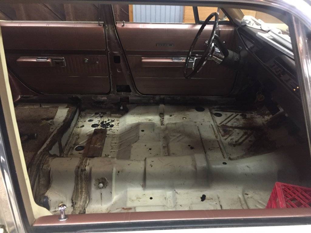

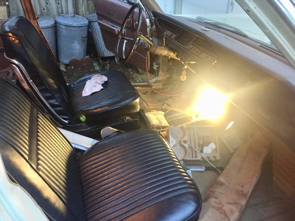

Not sure if this is what you are looking at ideas about or if this will help you, but my stepdad converted his 1967 Fury II station wagon to bucket seats and console. Here is a post I made about it in 2019 here called New '67 Fury II Station Wagon Interior. Factory style 1967 buckets were put in it.
