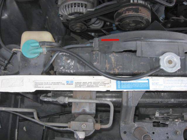

One other issue which got no answers 4 years ago. There is a 2 port temperature sensing valve in the radiator. I found the typical 3 port sensor in the intake and it is explained in the manual. However, I haven't found this one in the manual.
So what you see is what I got when I obtained the car. The one line runs all the way back to the vacuum amplifier while the other is capped. Can't be for looks so it must have been functional only where did the other vacuum line go to. It had to get a vacuum signal to possibly open the port to the line with the blue trace when the car reached operating temperature. Question is it manifold vacuum or ported vacuum?

Now who has a 360 engine with the two way thermal sensing valve on the radiator? Someone does as I don't have the only 360 engine.
