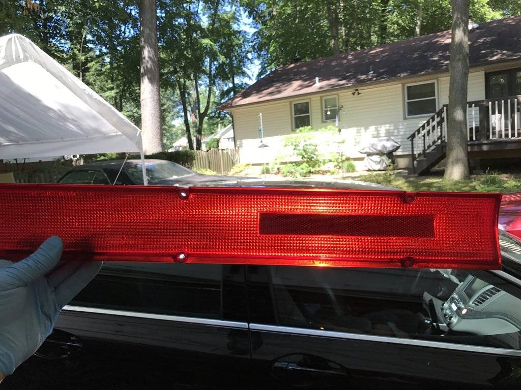

there it is, ok, its some kind of "filter"
The "clear" lense part will be the hard part to create
Will try to make one in whole red and then see how to do the backlight

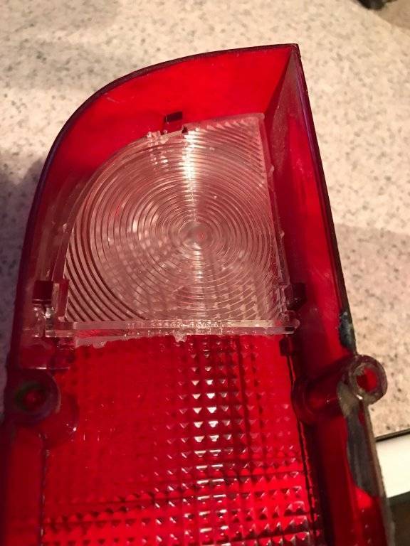

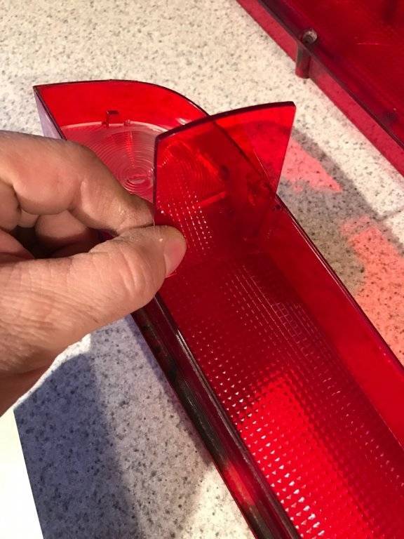

Here are a few more pictures after I removed the lenses from the bezel and cleaned them up. The collimator is a separate piece along with the clear insert. Both are glued in, but could probably be separated with some solvent, I'd guess. There are also part numbers for the collimators and the red filters.
Collimator
3403139 79886 LH
3403138 79886 RH
Filter:
3403141 79886 LH and RH
The collimator is a lens, not a filter. A filter is an entirely different animal.
The light rays disperse in all directions from the bulb. Some is bounced back off the reflector. The collimator straightens the light rays so they are parallel and don't spread with distance. In other words, it makes the light from the backup light shine directly behind the car.
Exactly, it's that red divider that the parts book calls a filter, not the clear lens. Interestingly the parts book makes no mention of the collimator, yet there is a distinct part number on the piece. Thanks to this thread I learned something new.
I'll bet the red filter is to keep any light from leaking into the backup lens and illuminating it. If it does "leak", it would be red and not white.

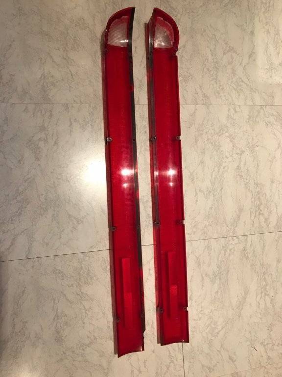

I spoke to the company today and we are going to try making the taillight lenses and the parking lenses. Starting with the parking lenses. The only problem will be the backup light "white" area. But we spoke about a solution so i hope we can fix that.
Great! $200 + shipping for the ones pictured, let me know.

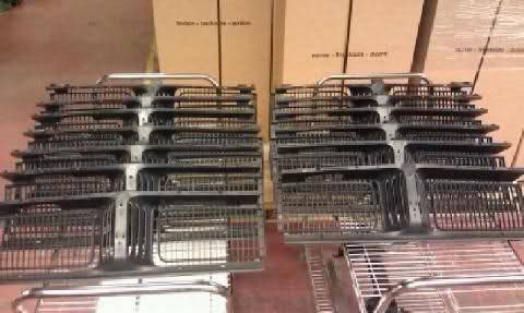

The charger 69 grille was way harder to do soo i guess we can figure this out!
Here is the grilles we made
