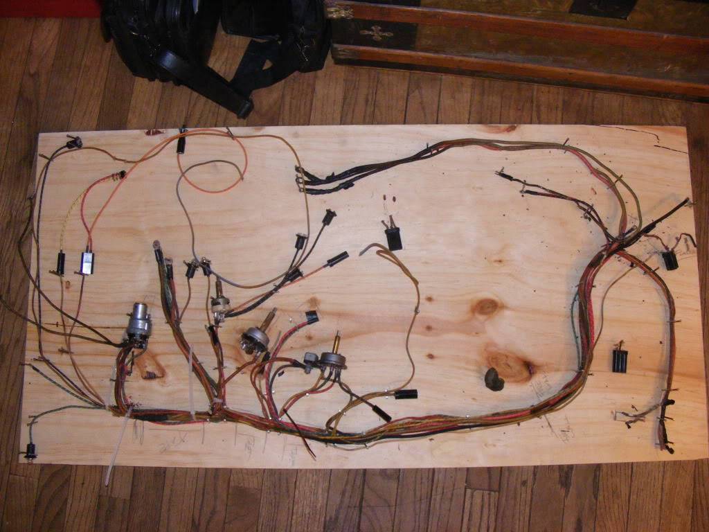

I'm not sure if you are just plugging the existing harness back in or are replacing wires... Here's how I repair harnesses...
I've redone a few harnesses and the way to do it is lay the old harness out on a piece of plywood. Then use finishing nails (nails with no head for wooden trim work) and outline the harness with the nails. Then, unwrap carefully and with the harness on your board, start pulling out and replacing one wire at a time.
You'll have to source the wire terminals, but if your careful, the insulators can be removed by inserting something small, like a jewelers screwdriver in the wire end and bending the little tab on the connector.
BTW, this is how they make short run production harnesses for all sorts of things.

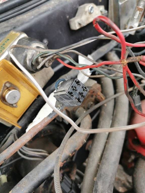

Thanks for the advice! I just want to reconnect the old harness to the car for the first part.

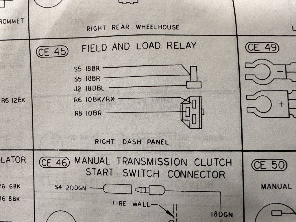

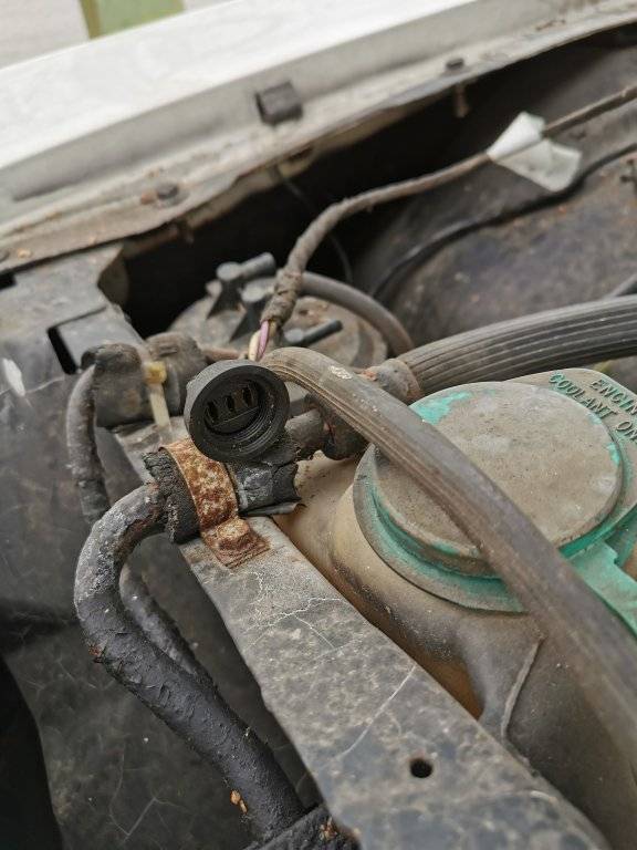

I cannot find those connections in my diagrams (maybe im blind) is anyone familiar with these plugs and knows where they go?
Top one is easy.
Neutral safety switch on transmission.
Not sure on others.

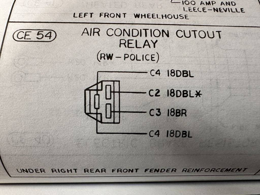

I only have up to 76 manual. The red looks like AC cut out in my manual. the six circuit black female block, I don't know. The round three circuit female plug looks like neutral safety switch.
I also theught about AC but the Ac is alredy correctly connected but ill have a look at it again.

I will get to the Wiring of the AC as soon as the Engine runs (the AC cutout relais is missing on my Car).
