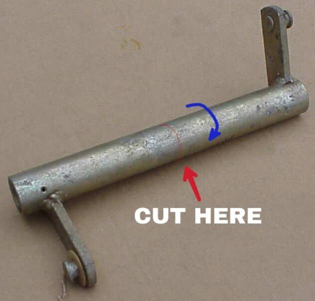

Is /6 z bar shorter, clocked differently, arms different than BB. I cut up a /6 a body one for my Barracuda years ago and re-clocked it but arm and tube length are same and the engine was not in the car in the right spot. Which I'm sure affected the clocking. I still have the z bar and when I compared it to my b body one my mods have it clocked the same.
I used the /6 3 spd z-bar. I cut it in the middle and welded it back the the correct width and clocking in one shot. Arms weren't touched. Clocking was very minor. Maybe 10°.

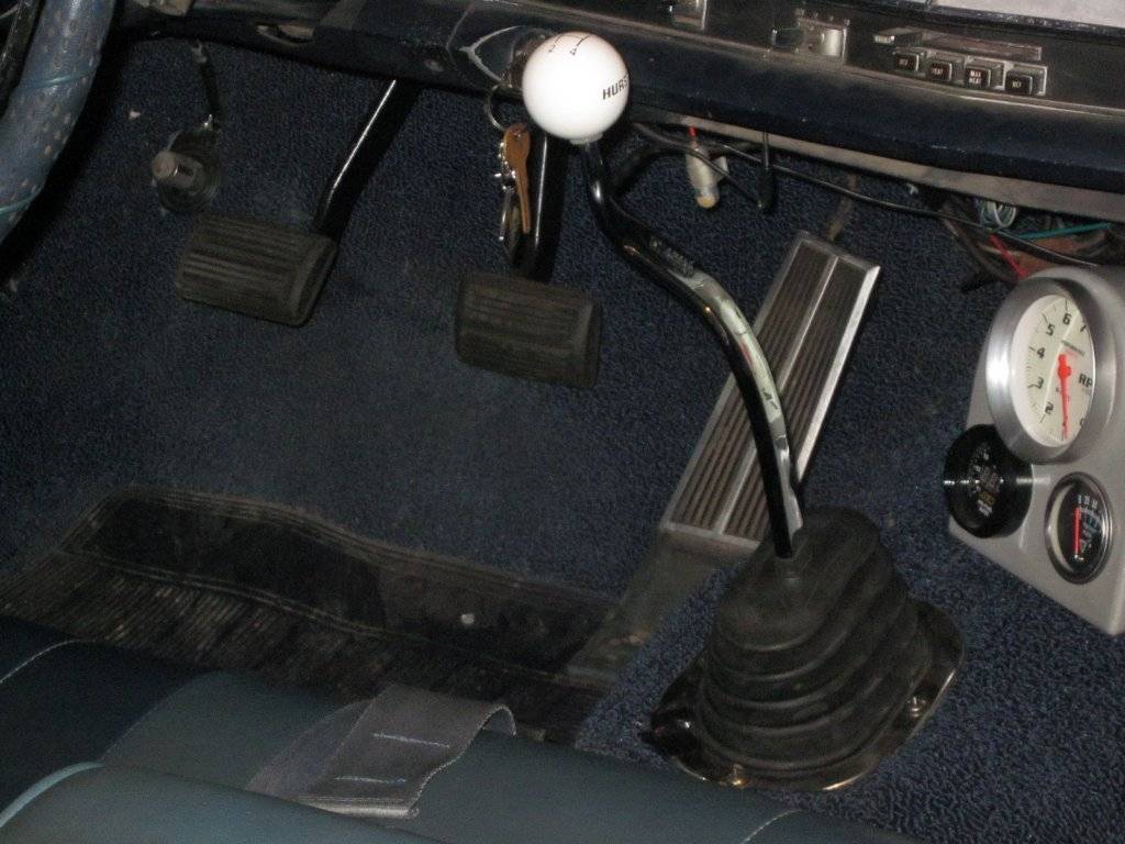

Hi,
I've been reading post on this site for loong time. First time posting for me.
I've done the conversion on my 67 300. the car ain't nice, but fun to drive.
Started with a manual brake clucth pedal. The pedal came from a 67Fury. It is faily easy to modify manual brake pedal to power brake.
I guess that the rod between clutch pedal and Z-bar is Cbody only.
I've mod my Z-bar from picture/tryout. took a while. Summit Z-bar didn't work(I sent it back). Z-bar that I modified came from a Mopar meet show. Searching thru pile of stuff, I find a Z-bar that was too long and the ear were also too long. The seller didn't know the car it was in.
Fork came from Brewer's, with bell number(I was Lucky enough to have the correct bell), they gave me the correct fork.
Brewer's help me a lot. I order a lot of clips, bolt, spring, washer, etc, from them.
Floor hump was from Harm's or something.
My new carpet didn't fit perfectly(even if I orderer it as such from manufacturer)
Hurst shiter(new) fit perfectly right and work great.
NB
engine is 505/stealth head, Comp cam XE275HL, 800 AVS, TM7, hedman's shorty.
Trans is 833 alu OD with bushed countershaft, centerforce clutch.
3.23 detroit locker
