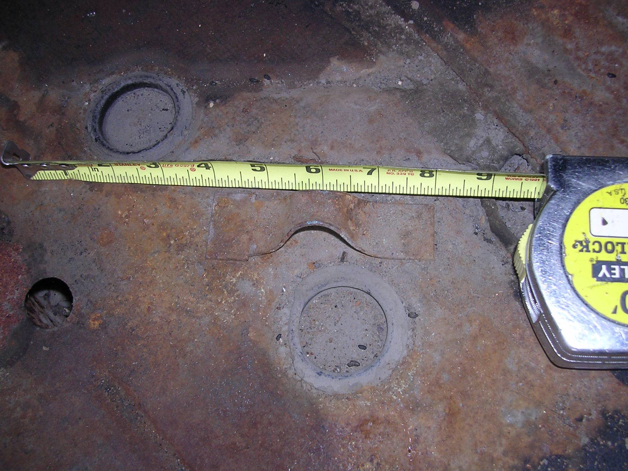

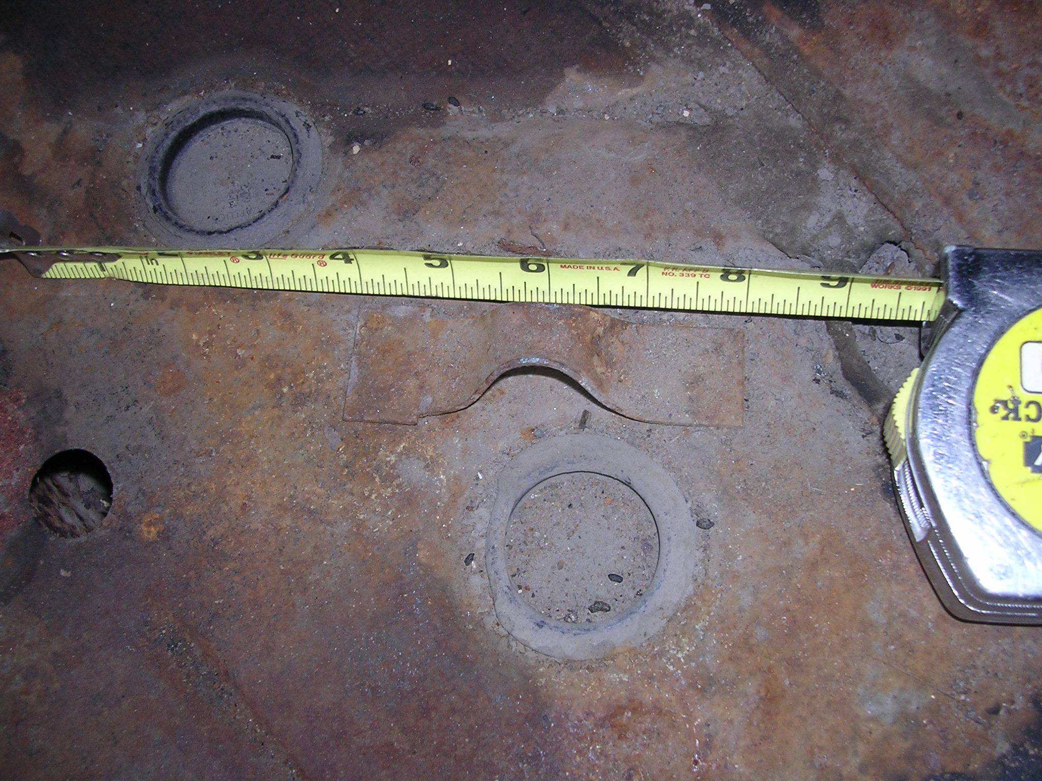

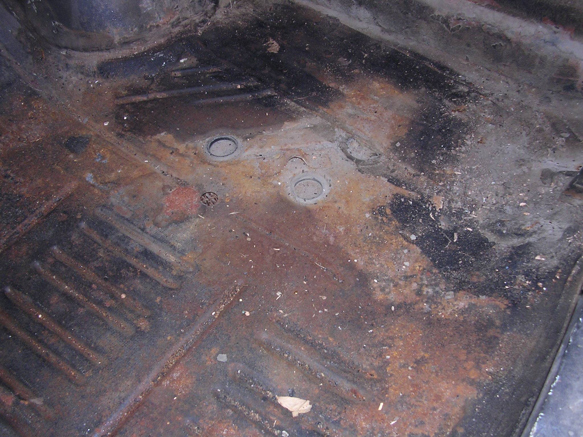

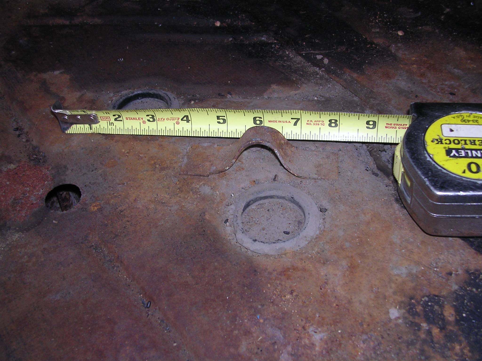

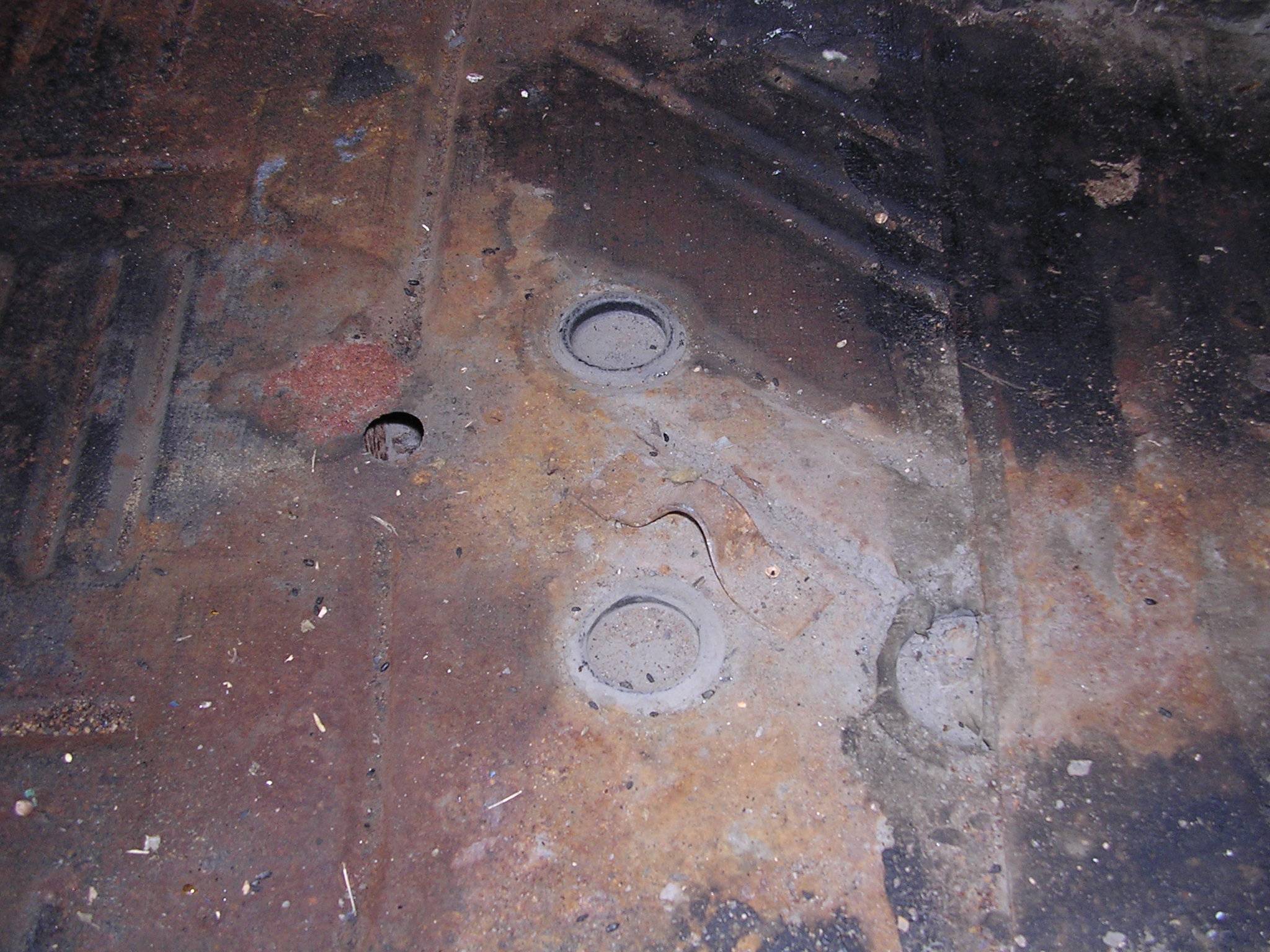

Need to thank you, I guess. I hadn't had that trunk lid open for several years, so first I had to clean out a couple large mouse nests. Then I'd forgotten how much "stuff" I'd packed in there so had to dig that out, makes a nice refresher on some of the spare parts anyway. But I did get a couple photos of the bracket although the holddown rod is long gone. Here's a couple pics for you, along with a gratis shot of left over mouse debris and I didn't put all the "stuff" back in so more pics will be easy if you want better ones. Oh yeah, this is on a 65 Polara convertible, not a 66.

Thanks very much! I'm sure there is not much difference from a 65 to a 66.
