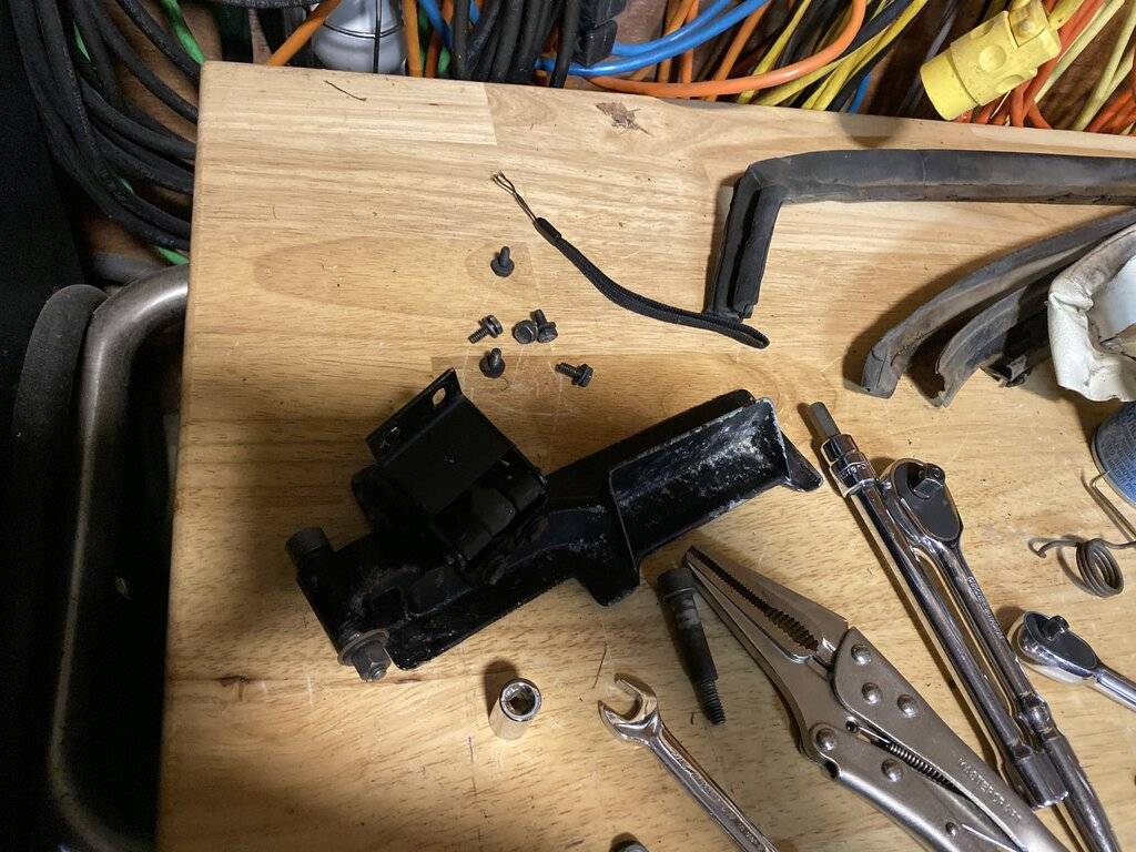

I’m trying to remove these

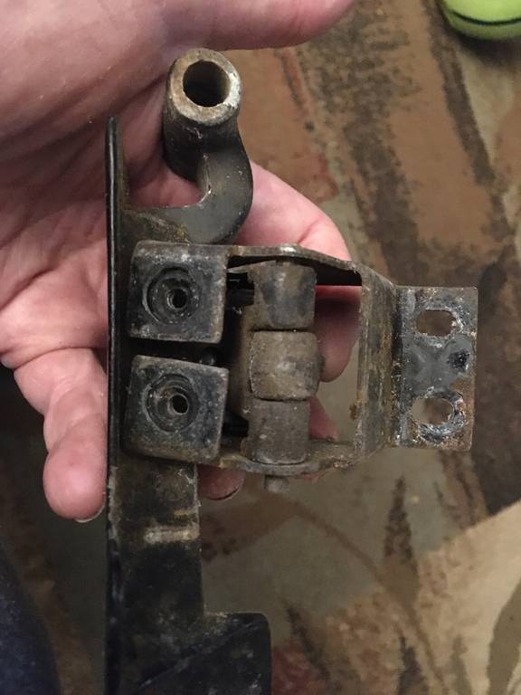

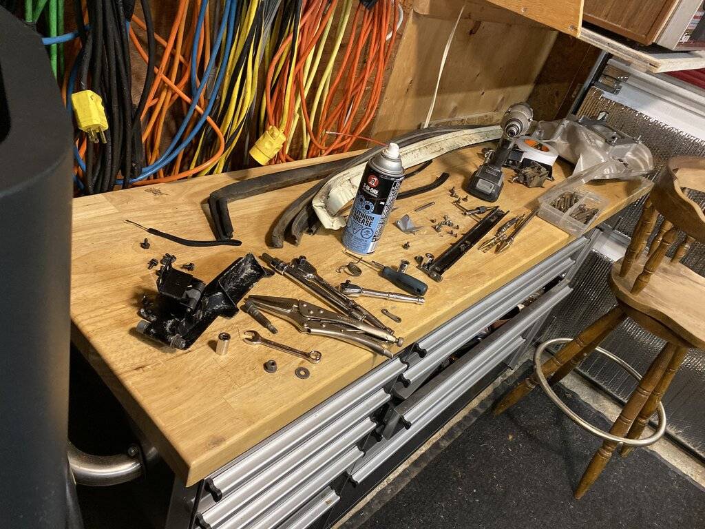

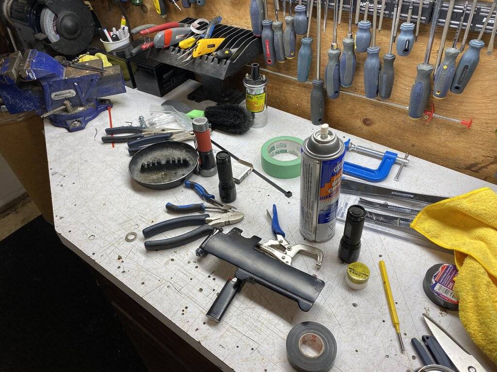

I can't remember exactly how they come out. I did take a pic of a spare I have.
4 holes, it looks like 2 from the bottom and 2 into the threaded holes, possibly from the top. As I said, I just don't remember.

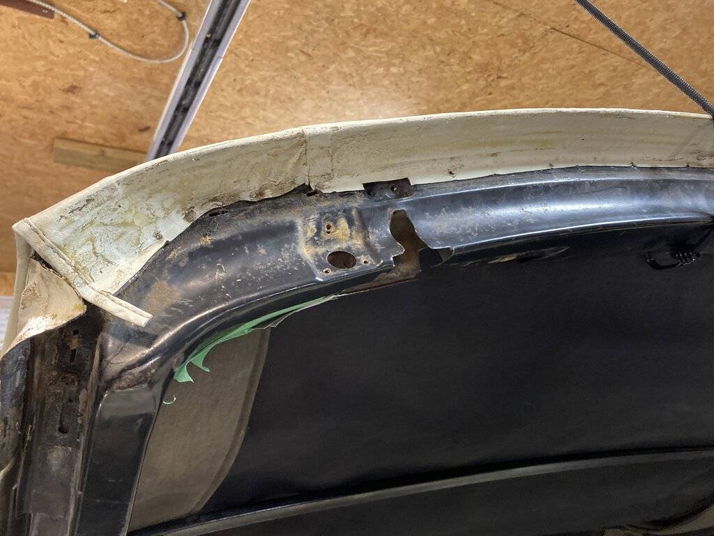

Thinking about it, it seems like the header panel has to come off... Geez... I can't remember.
Yep I think the header has to come off too. It has bolts holding it down. So I guess I’ll remove those rusty suckers. Thanks Big !

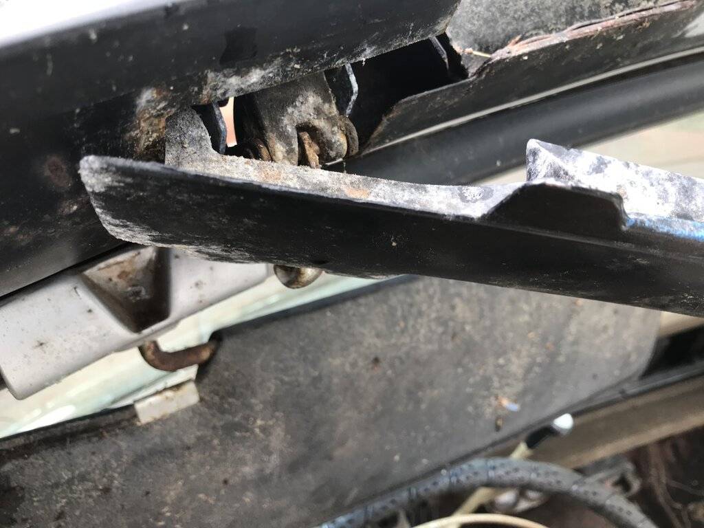

I had to fix one of mine a few years ago and can't exactly remember either. I believe I had to gently remove the weather stripping at the front and unscrew the metal strip to access a couple of bolts.

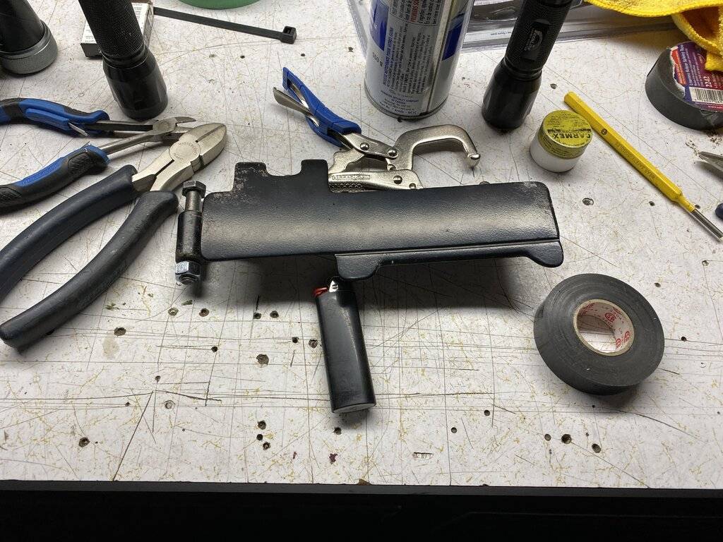

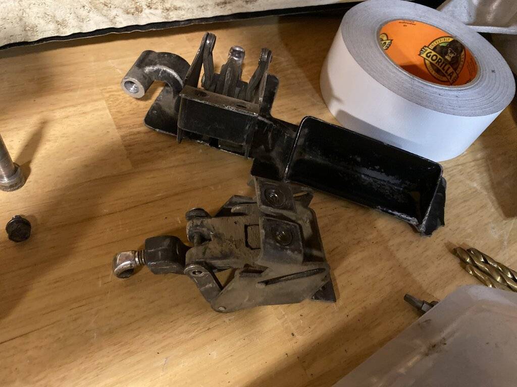

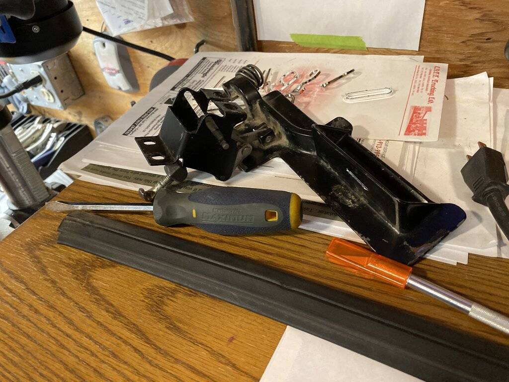

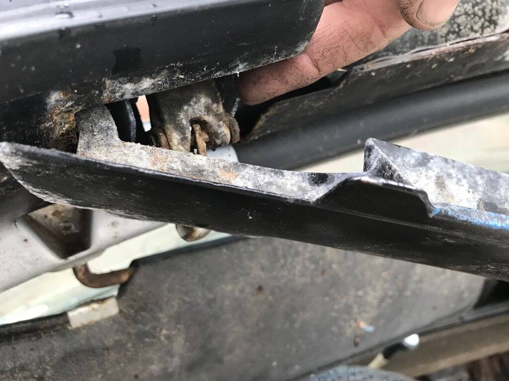

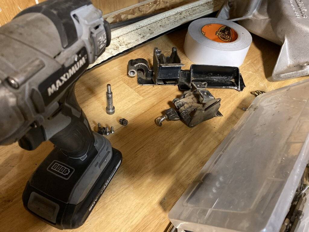

I just replaced both of mine over the winter with a couple of very good used ones out of a parts car. I have a few pictures. The hardest part for me was resetting the Lach return spring.
You take the weatherstripping off , then the metal strip. Then push up the end of the Spring till it in hooks to release the tension on the lach. Then Undo the four bolts and wiggle it out. To put the new one in you pretty well reverse the process To put the new one in your pretty well reverse the process. I made a special tool to rehook the spring, Re-hooking that damn spring was the hardest part of the whole job . When I get back home on Monday I will take some good pictures and go through the steps of what I am talking about . These are all the pictures I have on my phone at the moment

It’s not that bad but you need a Lot of patients. I Had two convertible tops and one convertible parts car to get 2 good latches. I got my experience from them. I used a modified 6 inch C clamp to re-hook the latch spring once the latch was installed. I ended up doing the first one 3 times till I got it right or until it worked. The second latch took about 15 minutes after I knew how to do it

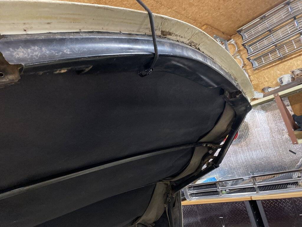

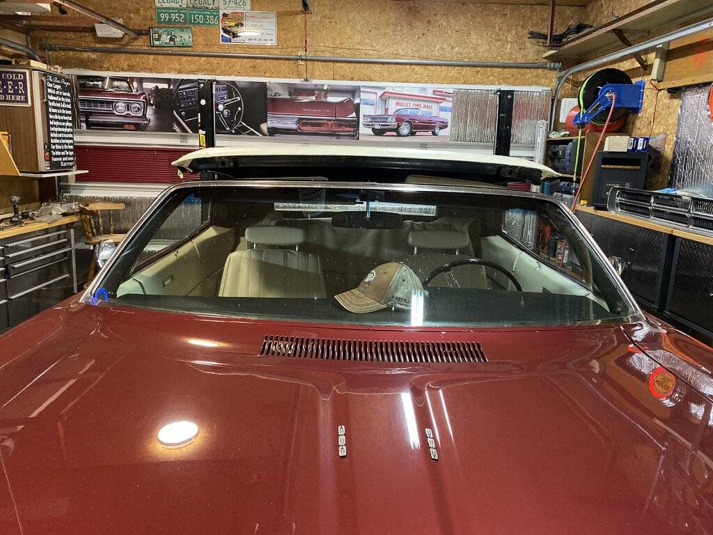

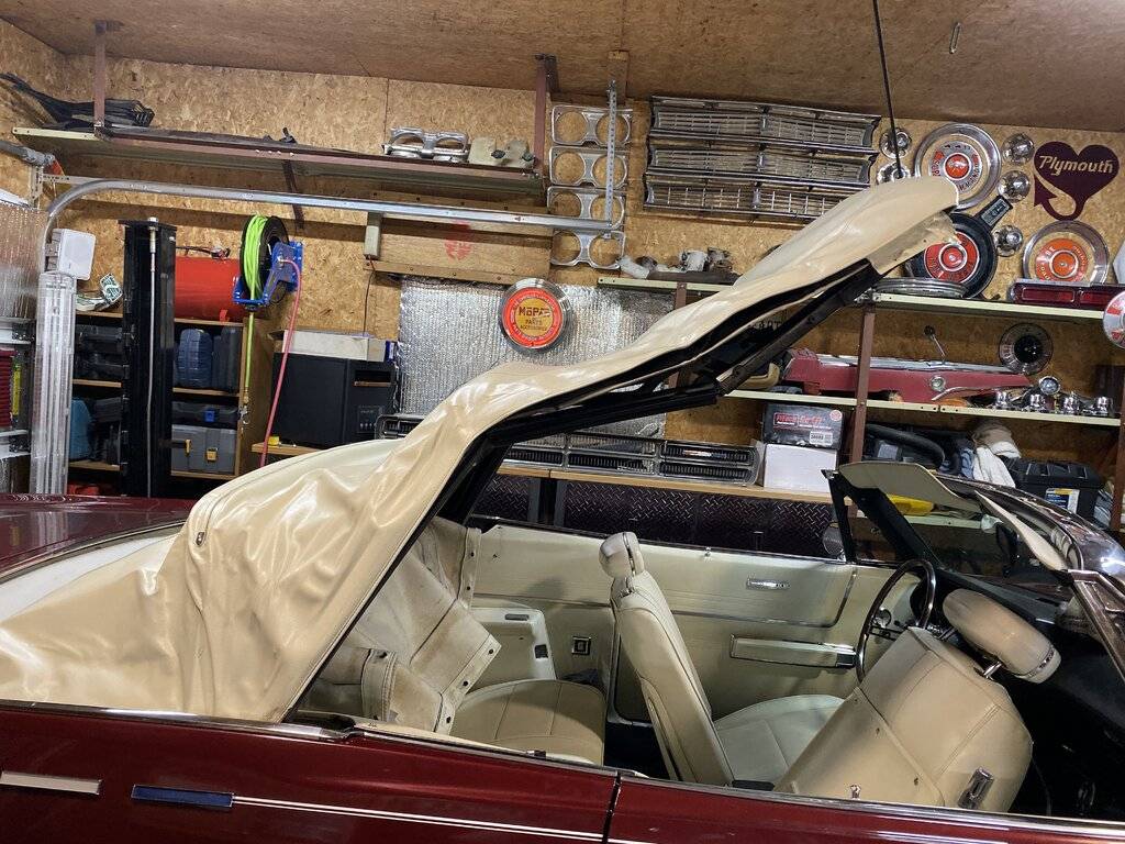

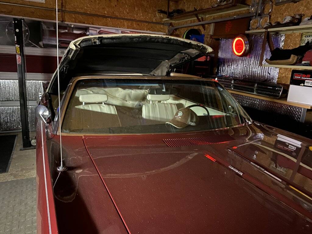

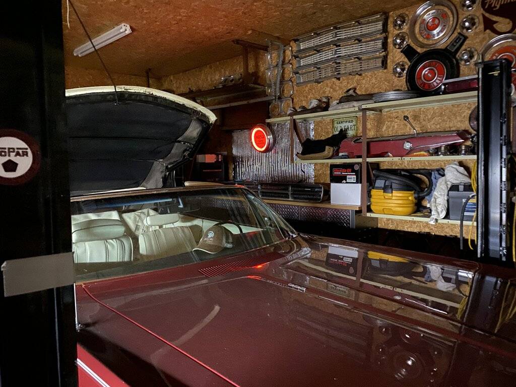

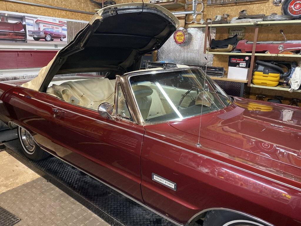

For my tools to fit , I had to suspend my roof at the balance point with a tarp strap . You will see it in the pictures. I used a 1/4” ratchet with socket and a open end ratchet end wrench to get the 4 small bolts out . With the roof at this position you have access to all parts
