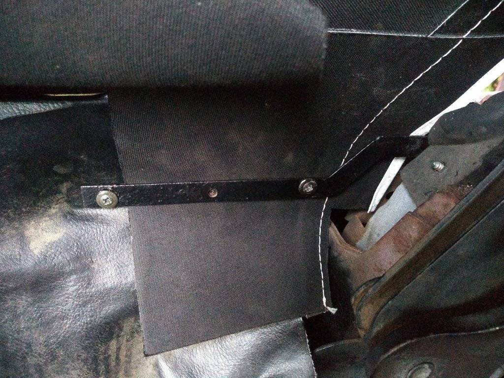

This is the Z retainer on the driver's side, so the raised portion is towards the front of the car. I believe there are just the 3 visible screw holes and the forward end just floats there, but will try to double check that this weekend.
That’s a great help and looks simple enough to make. I guess the reason the top doesn’t tear when installed this way is there’s a straight pull and not pulling it against an edge. Thank you!!
