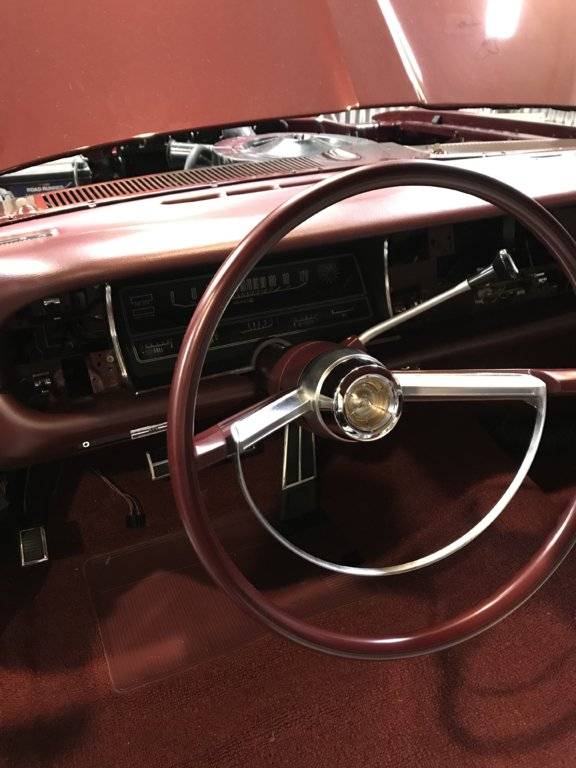

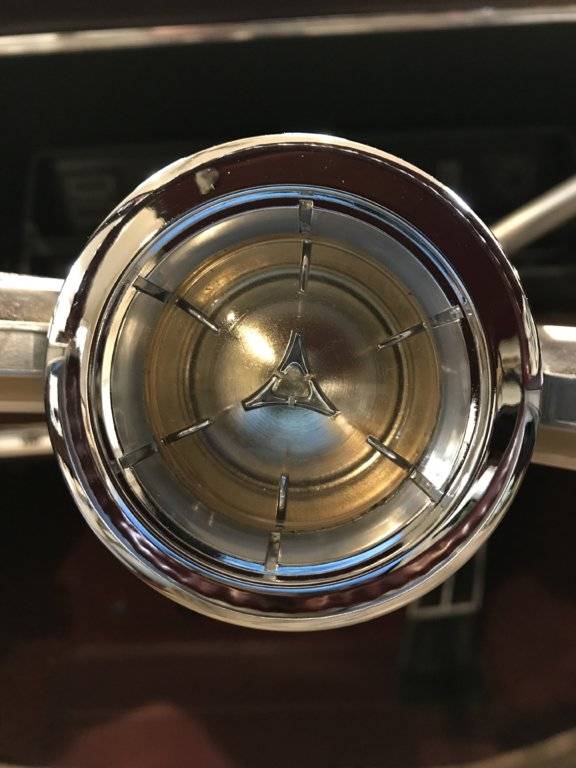

I'm sure the center piece is incorrect, but where did it come from? What model or era?
I had to move the car because roofers come tomorrow. Just now noticed it.

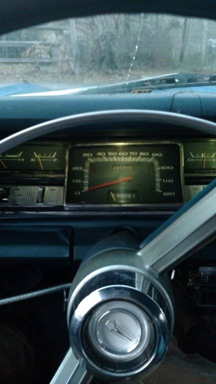

One more:

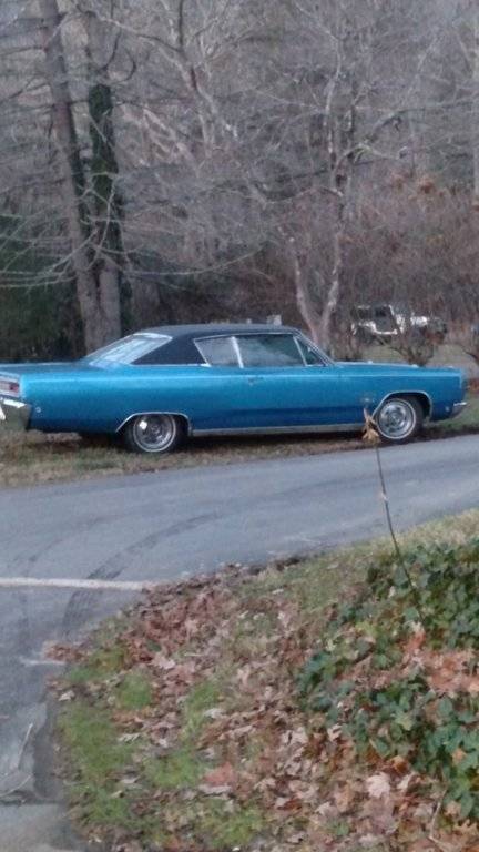

Mine is an August 1968 build. I found a blue padded one in the trunk. I like this one better, just wonder why it was changed.
My early ‘68 Polara has the Chrome center with the Fratzog symbol. Built August 1967, before some of the crash and emissions standards went into effect at the beginning of ‘68.
I prefer the chrome one over the colored one anyway.

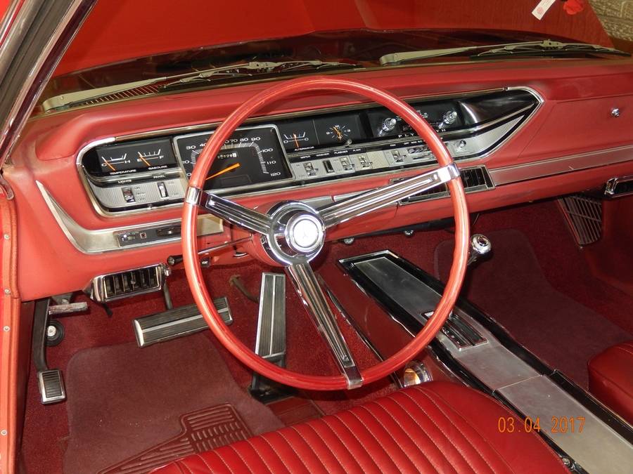

I have the same one on my 68 Fury. I was told by a few people at Carlisle that it was incorrect and I should have the padded one. But I have been looking; and have seen the same one on a number of 68 cars. I have the padded one on it now, but am starting to second guess if the chrome one was used in 68 also. My car was built April 1968.
Pretty sure that is a '67 center.
Just a wild guess, but they may have used it on some (early?) '68 builds too.
The early build '68 Furys used the Chrome 67 Fury steering wheel center. Keep in mind that as of 1/1/1968 Federal law mandated a reduction in glare, resulting in the switch from chrome interior A pillar, windshield trim, steering wheel centers etc. to painted or padded materials. In my experience, the chrome steering wheel centers were used for the first few months of 68 Fury production. My August build yellow 68 Sport Fury in addition to the chrome steering wheel center has chrome seat belt buckles and chrome vent knobs just like a 67.
