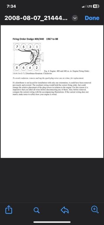

That may be possible, but there were no plug wires on the engine when I bought the car except for #7.
I think I would verify firing order, I dont remember off the top of my head, and position on cap. The left side of motor, cylinder front to back is #1,3,5,7. Right side even#. Locate #1 on the cap and position each wire in order.
carguy300
Jul 29, 2018
284
144
East Texas
1-8-4-3-6-5-7-2 going counterclockwise with 1 about the 5 o’clock position.
See if this helps.
Check for #1 TDC on the compression stroke. It has to be on the compression stroke.
If you had no wires, you wouldn't know what is truly #1.
