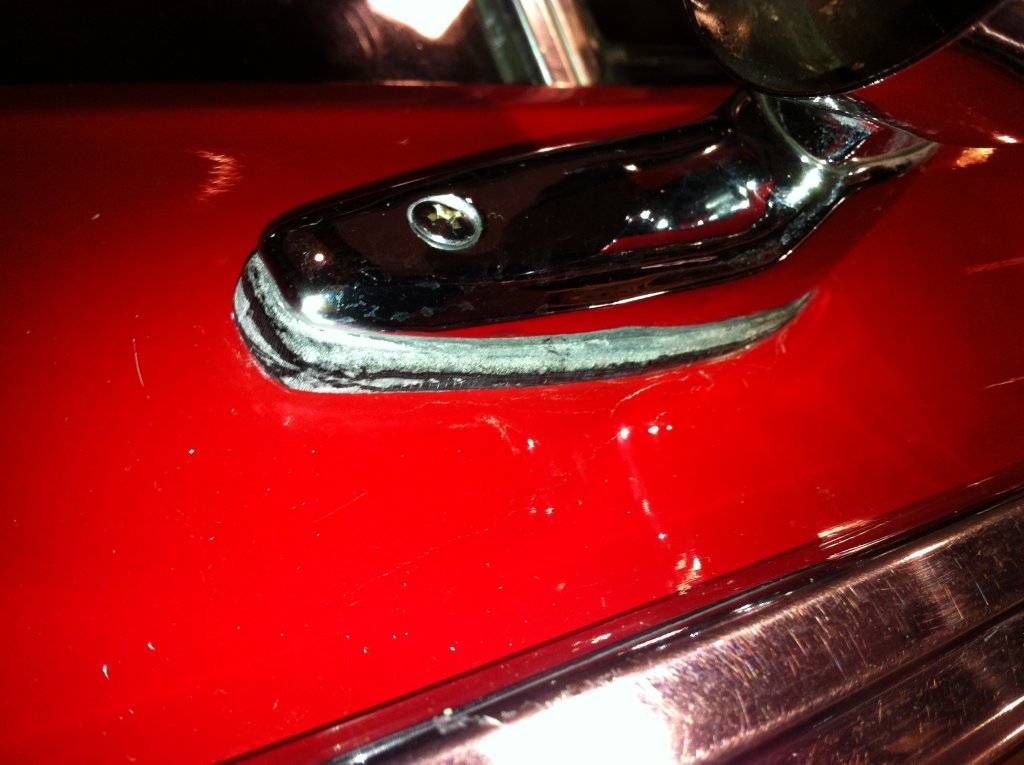

466 through 68 C bodies Mopar offered a wedge shaped rubber gasket for underneath the mirror to tilted up higher. They aren’t easy to find, but they are out there.
Like this, Bill? I searched around for one for the passenger side many years ago. Yes, hard to find!
