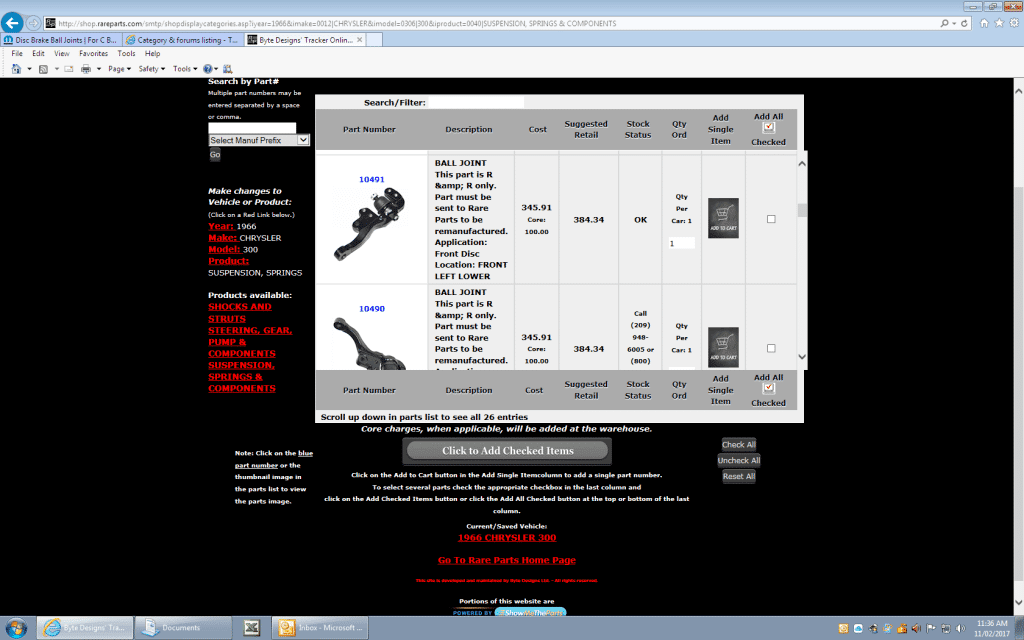

Rare parts has them or can rebuild yours in California . Expensive but no other option . NOS ones are now near non existent .
Rare Parts Online Catalog, SPRINGS & COMPONENTS
