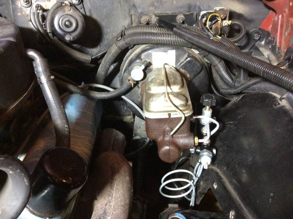

swapped a pair of 73 disc spindles onto my 69 300. New rotors new calipers new pads new proprtioning valve ( wilwood). I did not change out the master cylinder or brake booster as it already appeared to be a disc brake MC put in place by previous owner even though he was running power drum brakes.
Here is the problem, the car stops with the disc brakes but it doesn't feel like it is putting enough pressure to the front calipers.it is actually a worse response than with the drums. I have bled and re bled the brake lines, pedal stays hard does not drop and is not squishy, no leaks anywhere.
Where should I go from here ? Replace booster? Replace MC? Is the length of the brake piston or bore diameter different on disc vs drum cars?
All help appreciated. Pictures for reference attached.
Get a disc brake booster. Dual diaphragm puts up more boost.
Rockauto has it for about $112.

You do have the rear reservoir connected to the front brakes? The larger reservoir is for the front brakes.
It looks like both front and rear lines from the MC are running thru the prop valve. On my 66 swap the only line connected to the prop valve was for the rear brakes, 1 line in from the MC to the PV, 1 line out from PV to the rear brakes.

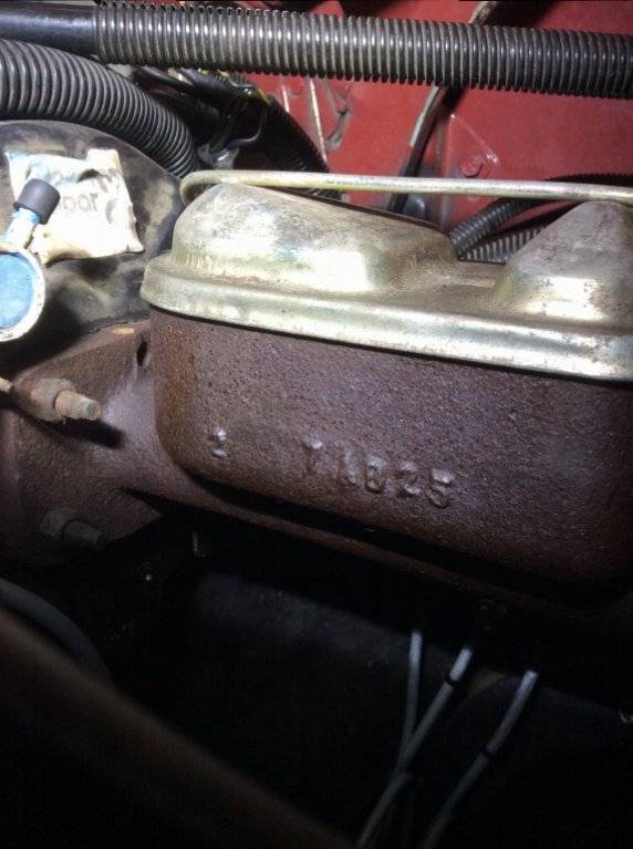

A minute on rock auto I found the rear wheel cylinder size is 15/16" for both applications... good and easy. the master cylinder size you are currently using should be 1" and if your 69 came with discs would have been 1 1/8" . The 73 newport would have used a 1 1/32" bore size master cylinder.
That basically means you will have a bit less pressure making ability with the 69 disc MC vs the 73 disc MC. If the 73 MC was a bolt up arrangement I would send you there... but I doubt that's the case. You will lose a little force multiplication using the 69 disc MC... there is an internet full of calculators to help you decide what the actual loss is. I'm not the one for that part.
With 69 power booster and MC and 73 brakes you will be sub 1973 stopping force by a number you might be able to live with. This is your time to either math it out or just go with trial and error and see if you like it. Now you should be able to find a casting number guide/application guide that may help you find if that MC casting (69) was ever used with a smaller bore... then you would have something that matches.

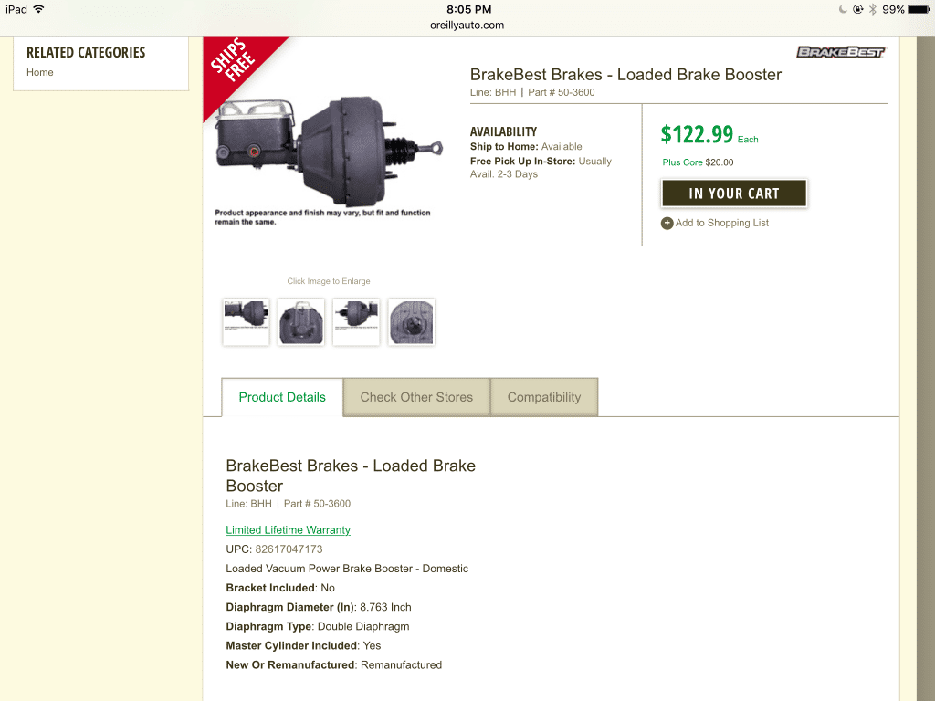

Dual diaphragm brake booster ordered for car with front disc and rear drum including MC . I will let y'all know how it turns out
if the one in the picture is the one you ordered , you will likely end up with something different. I went through this a little while ago. It seemed everywhere I checked that used that photo, none of them could actually get that model. In my case they sent me something that didnt fit my car

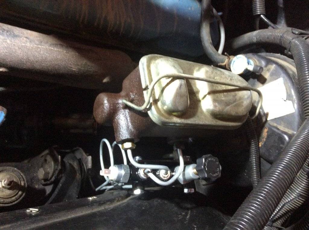

did you remove any stock combo or prop valves when you put the new poomlim unit?
just making sure you didn't plumb 1 combo valve up to another combo valve...
Yes removed old proportioning valve before putting in wilwood proportioning valve.
As for the power booster....that would explain why it has not shipped yet from oreilly. Rock auto said it did not have one.

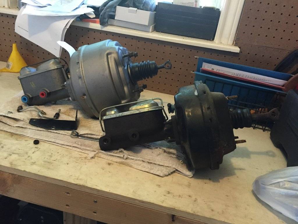

Oreilly order arrived today. Part matched picture and application. Once I get it installed an bled we will see if the booster is the problem.
That does not appear to be the same as the one that was shown earlier in this thread
The one pictured earlier in this thread is the one I was after, the one on the left in your picture is the they sent that did not fit. I have a 440 with HP manifolds and it wouldn't fit onto the studs
Ken
Booster fit perfectly but I had to make some new brake lines from the MC to the distribution block. Of course I stripped the new master cylinder rear reservoir threads while tightening the brake line . A new one is supposed to be here tomorrow before 2pm as most of the information I looked up on tapping the threads for a report sounded sketchy at best. Sometimes I think if it weren't for bad luck I'd have none at all. Ready to complete this project and get back on the road.
