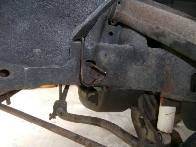

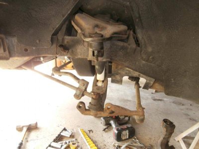

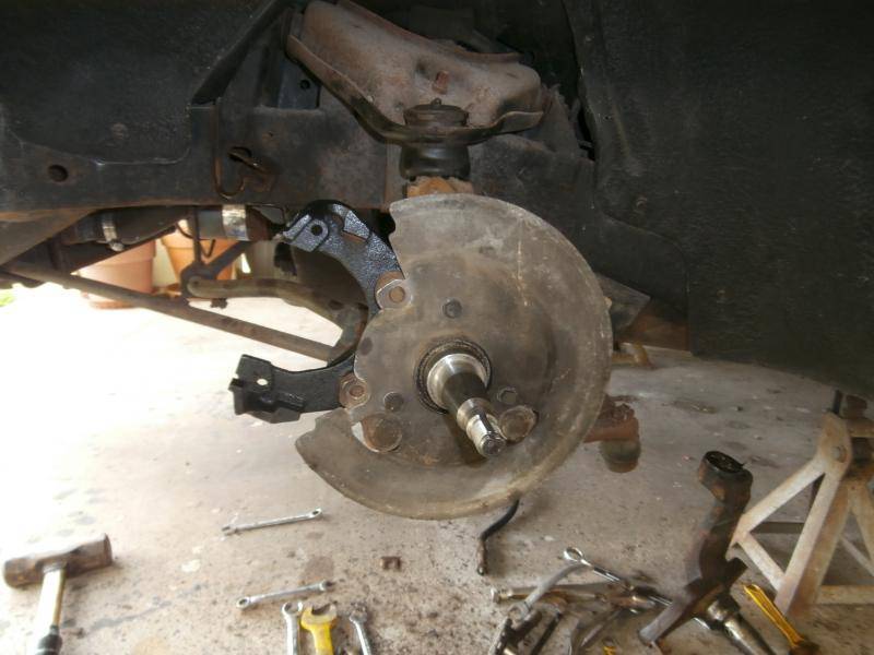

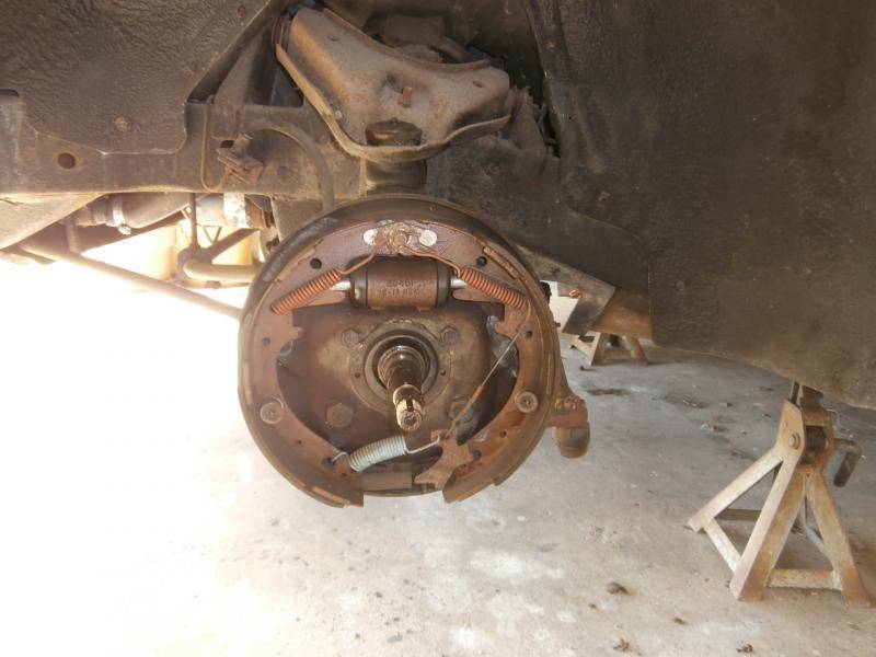

I am trying to put on my disk brakes and need a little help. My fourth pic has the spindle just hanging there. Do the calipers go on the front or back of the spindle? disk brakes 001.jpgdisk brakes 002.jpgdisk brakes 003.jpgdisk brakes 004.jpg

You can mount the caliper front or rear but rear mount makes the hose routing almost a bolt in. The factory 69-73's were rear mounted.
When I did mine I just had to slightly change the direction of the hard line where the flex line connects.
Kevin
I found my answer on Mopar action website disk o tech. Calipers are towards the front. I have the wrong spindle on there now.
That article uses pics from a B-body which were front mounted. I used the same info and after I got everything bolted up, there was no way to plumb the hoses without re-doing all the hard lines. Tear it all apart and swapped the spindles side to side and problem solved.
