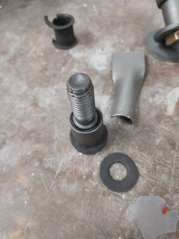

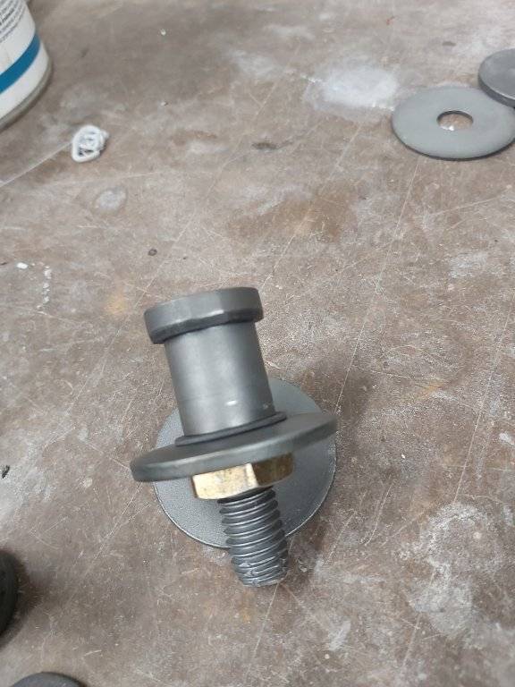

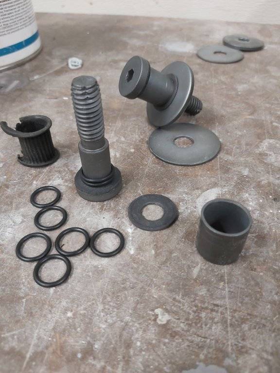

-69 Baron's lock strike bolt rubber insulators was in bad shape and needs replacing, but how to do it? Metal parts are recoated with nickel/zinc ( that's why the color is differentt than regular zinc). I was wandering how to make new insulation between parts and easy fix is simply two plastic washers and a few o-rings ! Just some lubricant when putting together.
