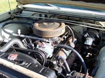

I got my kit to mount my compressor from Classic Auto Air.
You can see it in this picture the rear mounting point for the compressor attaches to the cylinder head. Just another option.

No my wife likes the sound of the 4 barrel opening when she goes to pass another car. This is what I had before the engine swap last year.
