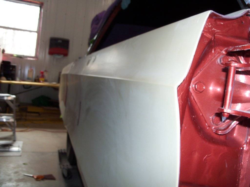

Like you,I had the front clip off. So I had to reference the rear quarter to line up the doors. Then line up the fenders to match the doors,and so on. Where everything was taken apart and jammed on so many times,once aligned properly i drilled 1/8 pilot holes on the hinges and fender mounting points for quick and easy alignment of the body lines.
A pump jack,piece of 2x4 and some tools to adjust the whole door to the car. A second pair of hands would be nice but with jack it can be done alone. I only snug a couple bolts during alignment and can move the door if needed. Much easier to line the door to the body with the fenders off,BTW.
Striker adjustment should be last.

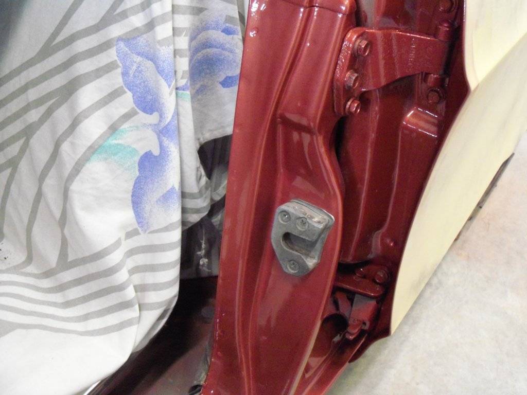

Sounds like the striker moved or twisted to an awkward angle. If it is not at the right angle it will bang hard and not shut all the way.
When adjusting the striker,close the door gently and with your outside door button depressed. Listen and feel if it had any resistance or is hitting the striker in a wrong way.
I use a piece of wood and hammer to move the door striker. I dab white lithium grease on the door striker to see where it is hitting or not hitting.
so I loosen the three screws until it moves then snug up only two around hand tight. close the door and check. Using the wood and hammer can fine tune the striker without have to start from scratch.
When happy with the adjustment tighten all screws and make sure they do not move!!

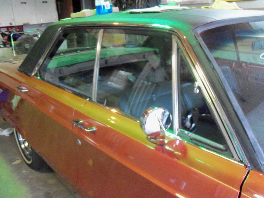

On all hardtop models, when adjusting I strongly recommend having the window up!!
What looks good with the window down may not work with the window up!
If you have to move the door out by 1/4 inch double check your glass against the weatherstripping.
If you have a gap,the door panel has to come off and the glass needs to be adjusted (tilted) inwards.
The vent wing frame also can be adjusted in and out as well.
