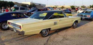

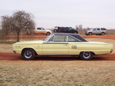

Below is my baby. I've owned this Coronet for 34 years now. The first pic is from when I was with the car for the film shoot for Heaven's Rain, which was filmed in February 2010. The bottom is how my car looks now.
