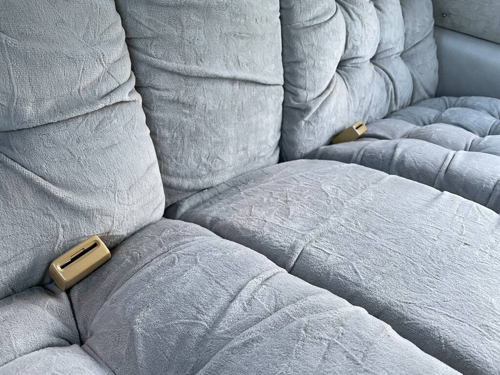

Hi does anyone know where I can send seatbelts to be painted and dyed Mine were missing. I found some online but the wrong color.
The problem with dyeing the belts is the color won't really bind to the material and will come off on your clothes.
Not great for impressing the ladies...
Does anyone have seatbelts in gray?
This is the part I need anyone have gray.
