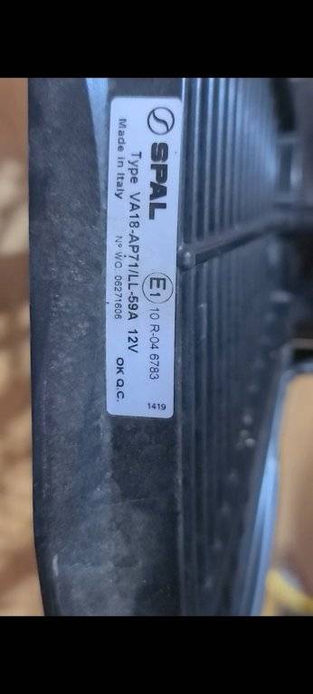

I'm curious about which model of SPAL fan you were using on your ride. I found something which resembles your description in this: VA18-AP71/LL-59A * 16"C/12V, though they rate it for a 40A fuse with a volumetric flux of 2024 cfm. Do you still have the factory nomenclature for your SPAL fan? I ask because I've seen ratings of 28 amperes for the actual running load, and 40A for a 13V fuse, but nothing like 60A. Could this be an overcurrent device rating? for example, you may have obtained an "80A" cheap chinese relay with that FFD, as I did. I'm uising it for the present, for warranty purposes, though I place FAR greater faith in my stockpiled 30A Bosch and Tycho/Bosch SSD relays than any chinese copy.
I'm impressed with SPAL's honesty more than any other firm in the after market radiator cooling fan racket. These people clearly calculate or measure the volume flux of their products with greater scruple than the rest, who simply take the product of rms air velocity with the cross sectional area of their fan, and suitable dimensional manipulations.
Duh I thought the 59A was the current draw rating!? Anyway i think that is the fan I have. Its very strong and blows stronger than the ffd for sure! I'm thinking doing two spal 10" fans on my condenser as pushers that only activate with the AC button and keep either the spal or the ffd as a puller.

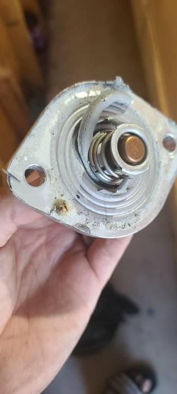

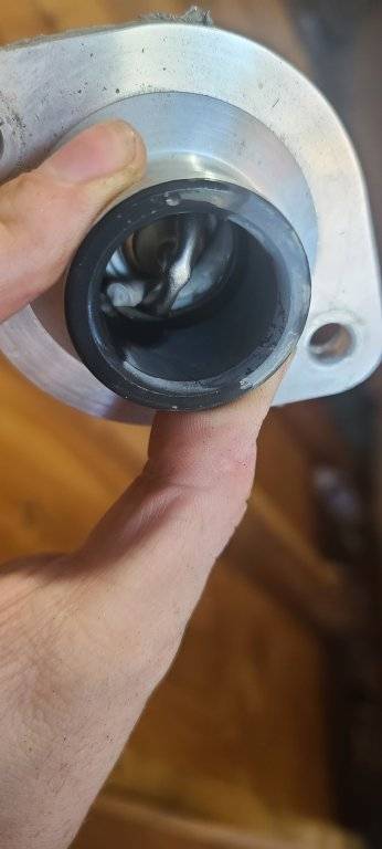

Working on gettin the shaw thermostat in and then the high flow waterpump looks like I found....a.little too much permatex

Got her buttoned up. Thermostat housing has a minor leak still but temp creeps up with ac on still...just a lot slower. If I set my fan on temp to 185° and off at 181° it will stay in that range but only with AC off. Thermostat is a high flow Robertshaw 180° .

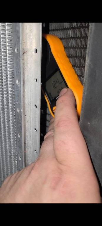

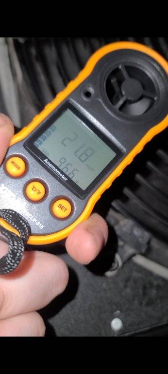

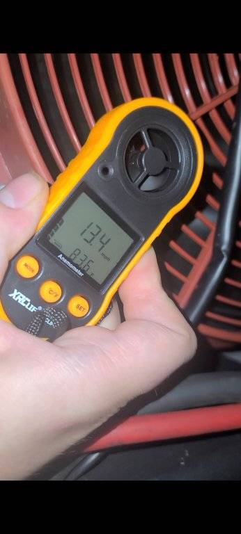

Here is the Spal. Both equal scenarios, Idle with AC on and Fan mounted to the shroud. Windspeed infront of the radiator was around 10 to 12mph I am waiting to hear back from FFD and see if they will make it right.
So I've been waiting a bit to post about this. I have been in contact with FFD and also essentially told them their product does not meet the specs they claimed and I would like to send the fan back and get a refund.
As a reply I got a rude email telling me that they benchtest their fans with oh so expensive equipment rambling about how expensive their equipment is and not with a 10$ walmart windspeed meter. Apperantly they also think any Vehicle produces 14.9v at idle since thats where they benchtest the fans at (no mention on the website for this of course!). They will only take the fan back to benchtest the airflow, which they want me to pay for. And of course pay return shipping and all that ontop of it.
Fact is, even the 10$ walmart windspeed meter says that the FFDynamics fan is nowhere even close to 35mph windspeeds like they claimed to me in a previous conversation. And my lower rated spal outperforms their product.
I replied and said I wont be paying for sh*** and that their product is simply not up to par and does not perform as advertised and we dont drive vehicles on a bench but in real life. I also said I was going to post about this on here, where their company was recommended....
Have not gotten a reply. BEWARE their warranty and return policy screams Scam! You are stuck with the product either way.
