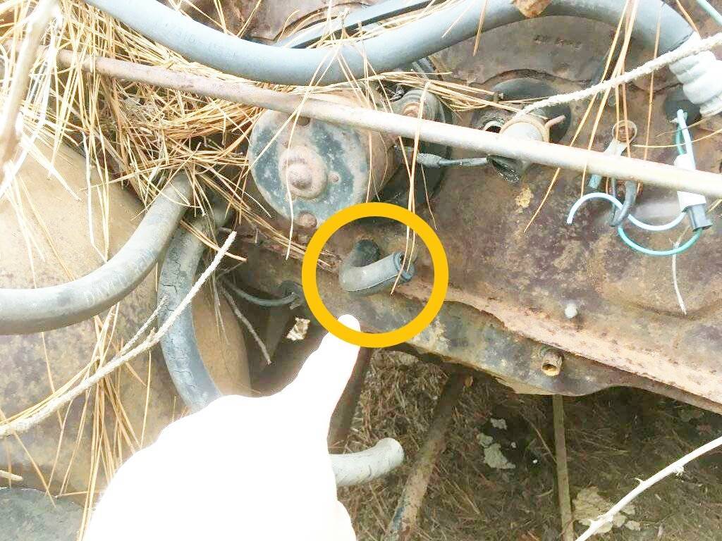

Good morning guys. I'm referring to rubber elbows that would connect to the metal tubes that protrude from the firewall. This may or may not be an actual part. I thought these may have existed to divert the water down to avoid it leaking into the cabin. I could be wrong.

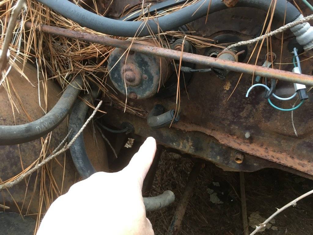

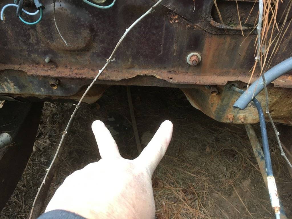

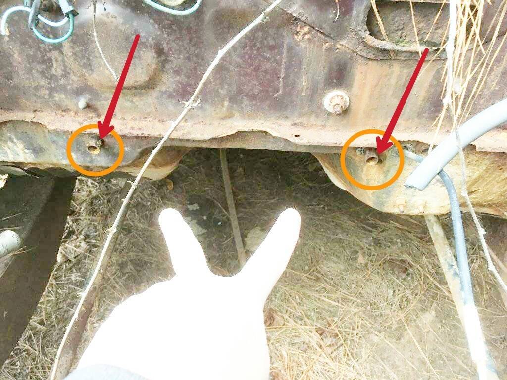

Here's what I have. 65 New Yorker with a/c. First pic is blower vent. Second pic is the drain tubes at trans tunnel. My 68 Fury didn't have anything that I could see. I also looked at my 66 Polara it it looks the same as the 65 New Yorker. If you see anything you need let me know
I lightened up the pics so people could see what is being talked about a little better. Thanks for the pics.

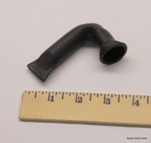

For the evaporator drain tube, here's an E-body repop.
My repop fit Stan but I can't remember where I got it. Gary Goers possibly.
