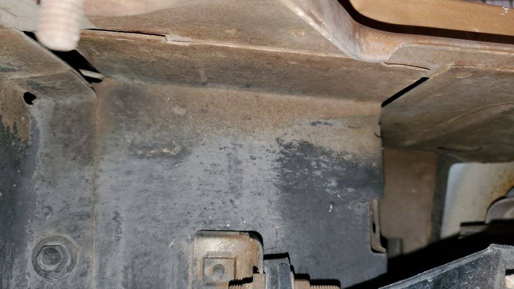

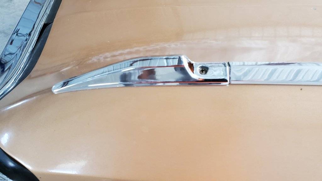

69 Chrysler 300, have an intermittent fender indicator. Remove the screw, indicator is loose, but unable to seperate from fender trim and remove. No access from underneath. How does this come apart without breaking it?

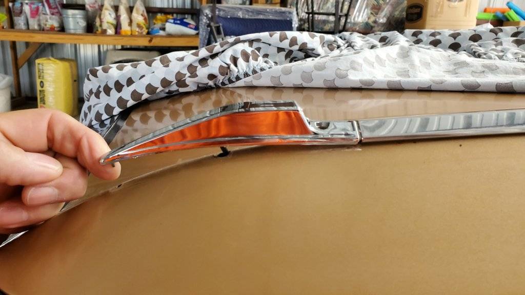

Remove the stainless trim from the fender w/ the screw removed in the following steps. First apply masking tape to the fender on both sides of the trim to avoid scratching the paint. Next w/ your trim removal tool carefully pop the trim off the fender starting at the rear and moving forward. Raise the trim slightly and slide it out of the turn signal bezel. Now carefully lift the rear of the turn signal bezel and carefully lift it from the fender
Thank you all, but lacking a Trim removal tool. I get the concept now.
