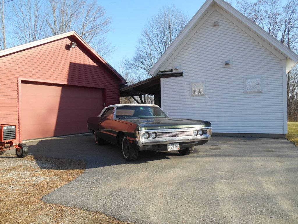

Every time I look at this thing I like it more. I just wish it was May instead of November. Going into storage Tuesday.I wish I had built a bigger shop!:BangHead:

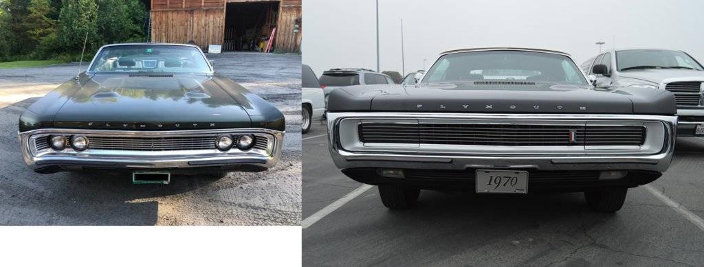

The only things I really would like to add is a proper set of mirrors,a proper thumbwheel AM/FM radio, a set of correct road wheels and a sport hidden headlight grille. Not asking for much eh?:lol:

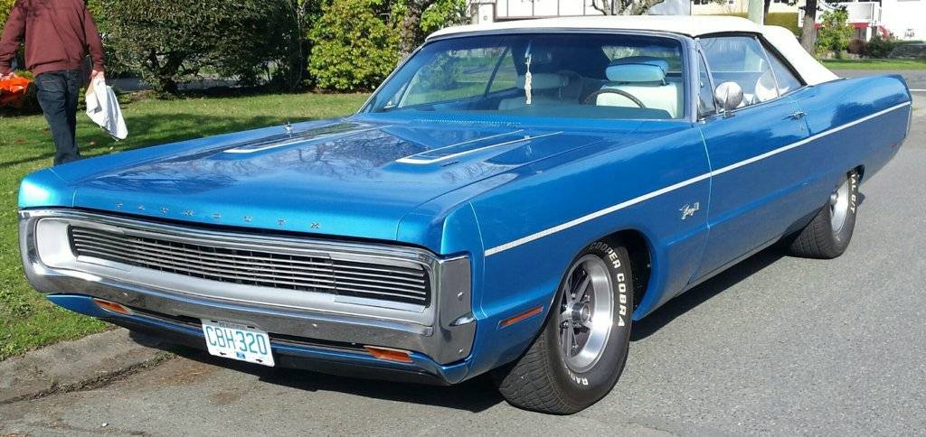

Best way to find out about the mirror is to check for part numbers and see if they match. Physically they look very similar. And you’re correct @Samplingman the Fury’s mirror mounts on top of the door rather then on the side like the Dodges, Chryslers or Imperials.
However, I just can’t imagine Chrysler making a mirror specific to the Plymouth’s and not cheaping out; using the same mirror across the whole body line
You want it the way you want it, I love the look of the sport hidden light grill.:thumbsup:
I know.Has anyone done this swap and know if the center section of the grille is the same on both?
The center section is not the same. You’ll have to source the motor, hidden headlight buckets, headlight covers, grille, and grille surround. Thankfully they are usually sold in 1 whole package.

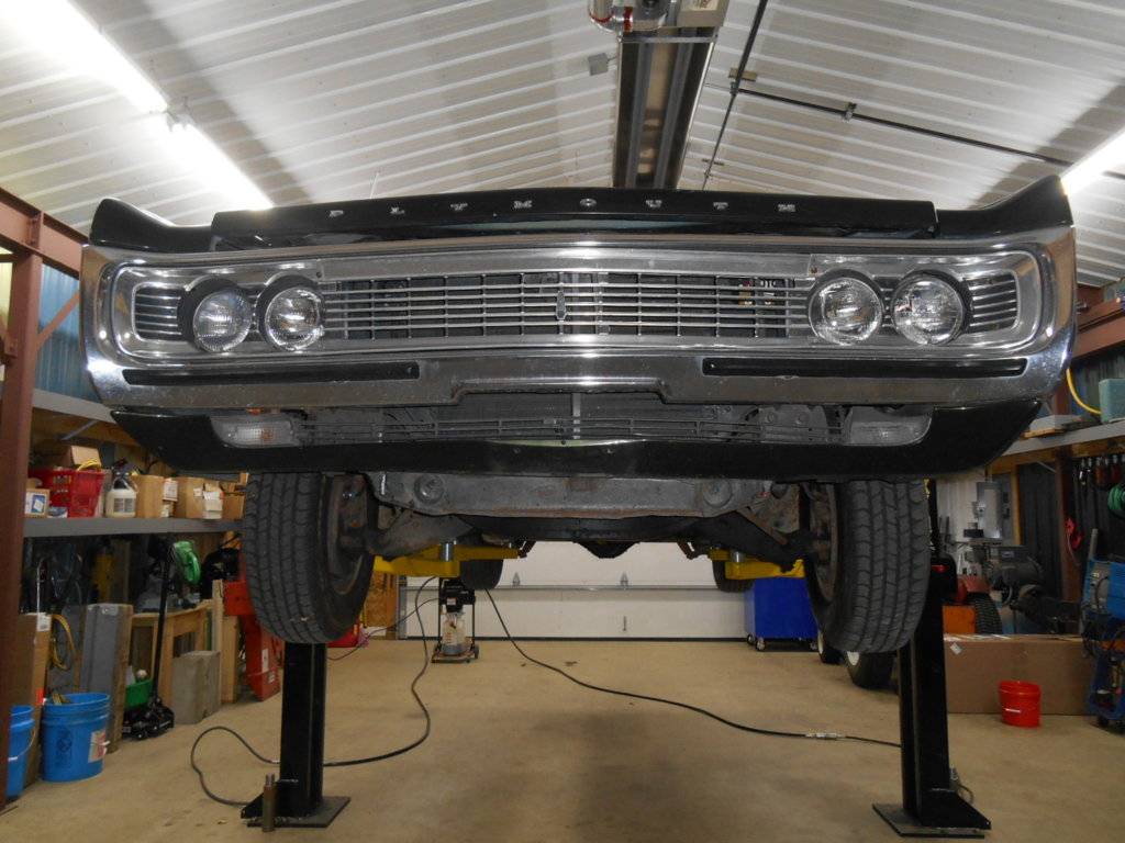

Up in the air 1 day before going to sleep for the winter.Car is even more solid now that I have gone over it from underneath.Worst thing is the oil leaks from the engine.Easy fix in the spring.Can't wait.
The chrome bumper is the same, everything inside is different. When I changed mine I had a hard time deciding between the 1971 and the 1970 since both years use the same loop type chrome bumper and the hood fit is the same. I ended up buying both '70 and '71 before eventually deciding to stick with '70. I did however use '71 head light buckets which have the required cutouts to mount headlight washers. The washers are a maybe in the future add on.

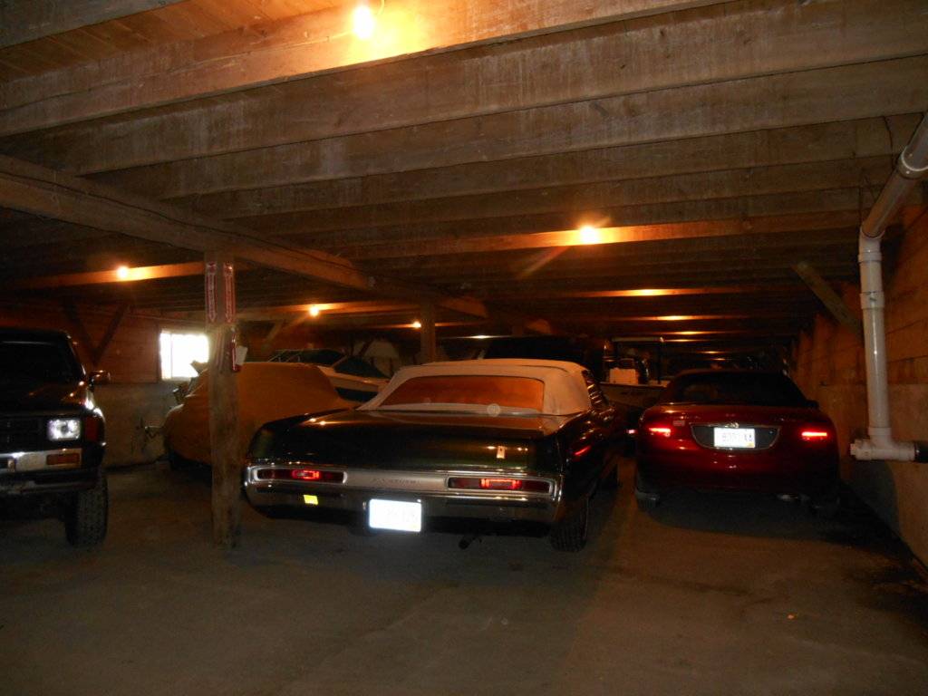

The drive over to the storage building was 18 miles and was really fun.Car ran great, but the suspension was very "floaty" and took a little getting used too.I think one of my exhaust manifolds has a crack in it and 1 of the top latches is broken and kept coming loose.Other wise a great drive on a beautiful sunny 50 degree day in Maine! Gone 'til spring...time to start gathering parts.

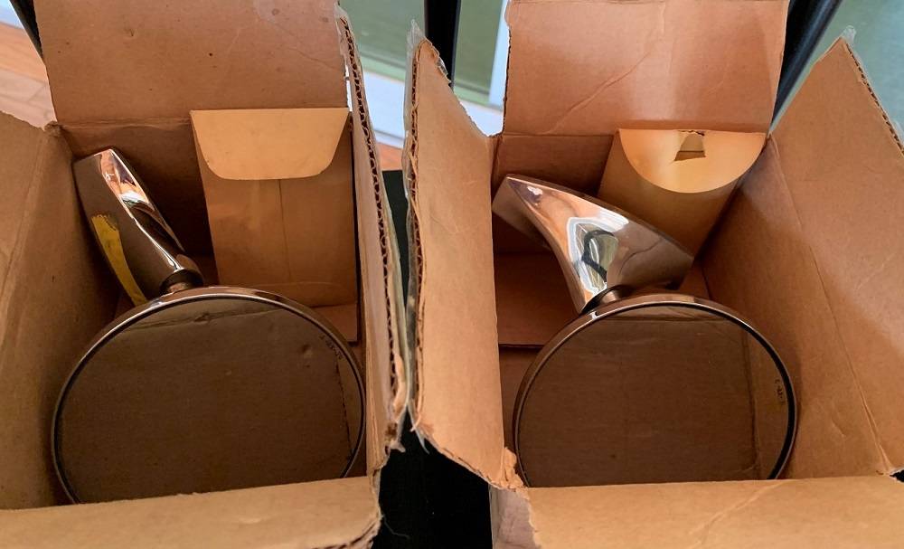

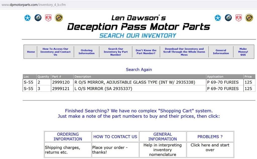

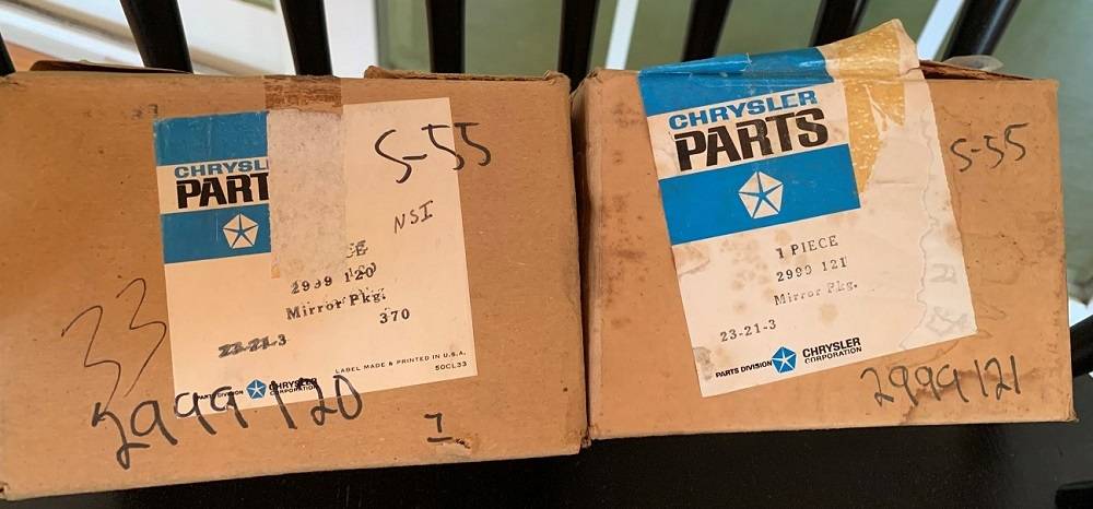

I have decided to resurrect this old thread so I can continue the story of my 1970 Fury convertible. I finally found some correct mirrors for it (thanks to MartyMopar) at Len Dawsons Deception Pass Motors.$275 shipped for the pair...pricey, but worth it IMHO.He has more if someone is looking.They were packed in 1982 newspaper...interesting.

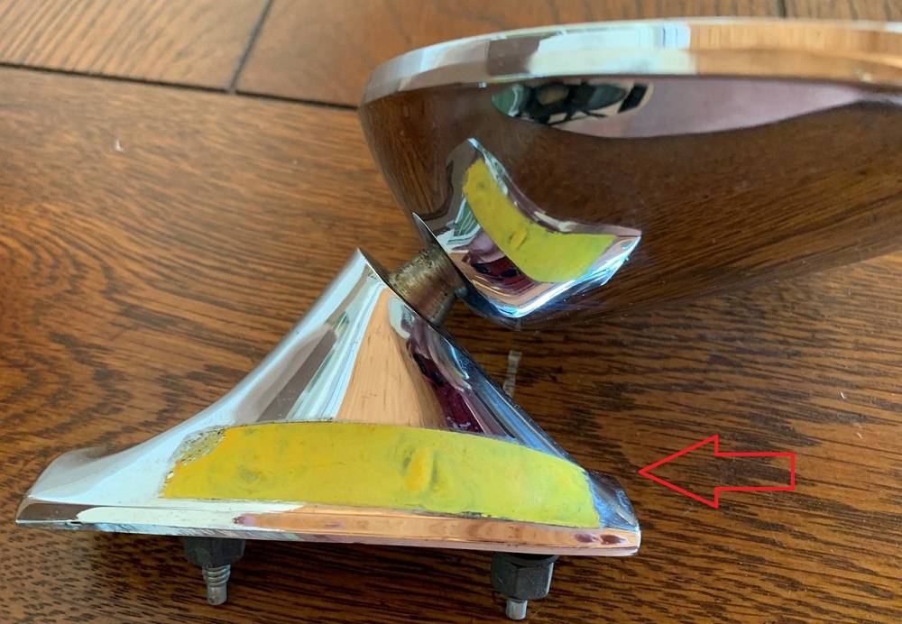

Does anybody have any ideas on removing the yellow strip without damaging the chrome?It was a "made in Canada" sticker on both mirrors.Thanks
