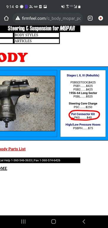

Hey guys trying to figure out what the hell the pot connector kit is from firm feel. I need a new steering box so I figured I would go with these guys as I've heard good things. Supposedly they discontinued the pot connector kit and I just can't seem to find any online, I guess maybe because I don't know what the hell I'm looking for or if there is another name for it. Any pics or where I could find one would be super helpful! Thanks!

I sent an email with the part numbers I needed and they said they discontinued the pot connector kit and they said that I may be able to find one somewhere else online. So yeah i have no idea what the pot connector kit is as that is what they labeled it as, see picture.

So yes the pot connector kit is the steering coupler rebuild kit.

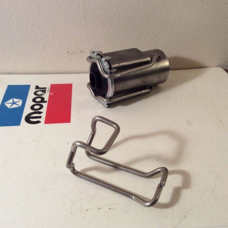

IMHO, the spring clip is a must.
There are some NOS kits out there, but they are very pricey in comparison and I'm sure the Dorman kit will work just fine.
Does this spring clip fit 65 c bodies with power steering
Good question... As far as I know, the coupler has to be the one that's 3" long for the spring clip to fit. So, I don't know if any available will fit the stock '65 Fury as I see the listings start at 1966.
So, I don't know.
Some info on these. I know, it's a '69 TSB listing, but go down to 69-19-4 and read through that for the reasoning behind the clip. The 1970 Hamtramck Registry "1969 PLYMOUTH, CHRYSLER & IMPERIAL TSBs Index" Page
