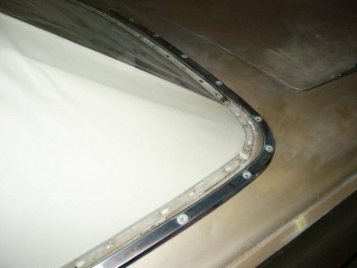

It's not a Fury, and it's not a 68, but here are the only pictures I have of my 65. This should be a similar installation. The stainless cover is laying next to the fastening strip.
Maybe Rexus31 has better ones.

I just had my 68 300 done and my installer said something about the tack strip he had to deal with.
Thanks 300rag for the photos.
I thought that is how it was fitted. My trimmer thought the was a tack strip under the metal retainer but from the photos it looks like is is glued to the body and then secured with the retainers.
Thanks guys.
300rag from what you can see does there look like there is any tack strip under the steel retainer?
Cheers Trevor
... but from the photos it looks like is is glued to the body and then secured with the retainers....
I think that is the case, but for some reason I remember a rubberized gasket type material under the roof vinyl. Again, maybe someone else like Zymurgy, or Rexus31, or Bryan has a more definitive answer.
