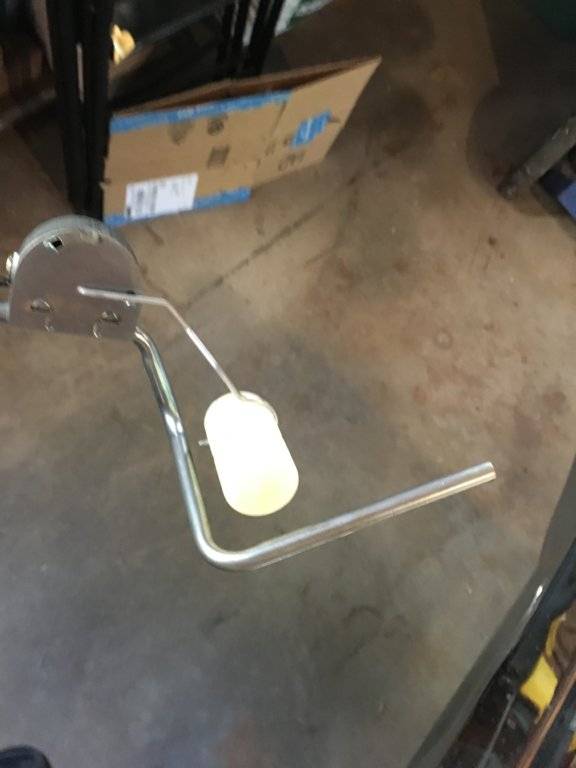

Your just missing the sock. That's a pretty clean lookin sending unit you got there
It's basically brand new, can't figure out why the sock dropped off. Problem is more that I kind of skimped when I did the system last time. I didn't have the scratch to replace the tank so I boiled the old one, replaced the sending unit and filler grommet and put it back together. The sediment in the tank this go around was almost as bad as the last... so now, new tank, sender, seal and retaining ring (and correct tool), filler grommet, insulation and straps. I wanted to wait to do a full restore but, screw it. The less I have to drop that tank, the happier I'll be.
Are you sure the sock was there in the first place ? Many new repop sending units don't come with one and the socks, when they do exist, don't come off none too easily.
If I remember right? The sox should kinda be a snug fit as you push it on the unit. So it must be sittin in the bottom of the tank if your sure there was one at one time.
There was, fished it out of the tank.
Yes. It just kinda slides on and off. Something wasn't right about that part of the unit.
