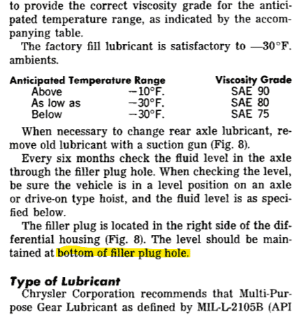

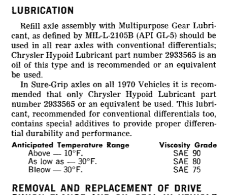

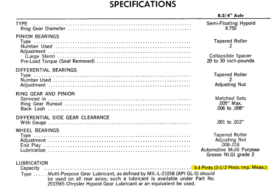

Wanting to replace my potentially 50+ year old gear oil, the local shop did not have 90 weight oil in stock on the shelves.
Lots of synthetic gear oils with a range that includes 90 (ie 75w-x), etc.
Are these permissible to use in our differentials?
Mine is a 1968. And how much gear oil is needed to fill the differential after the olde stuff is sucked out? (I want to make sure I buy enough in one trip.)
