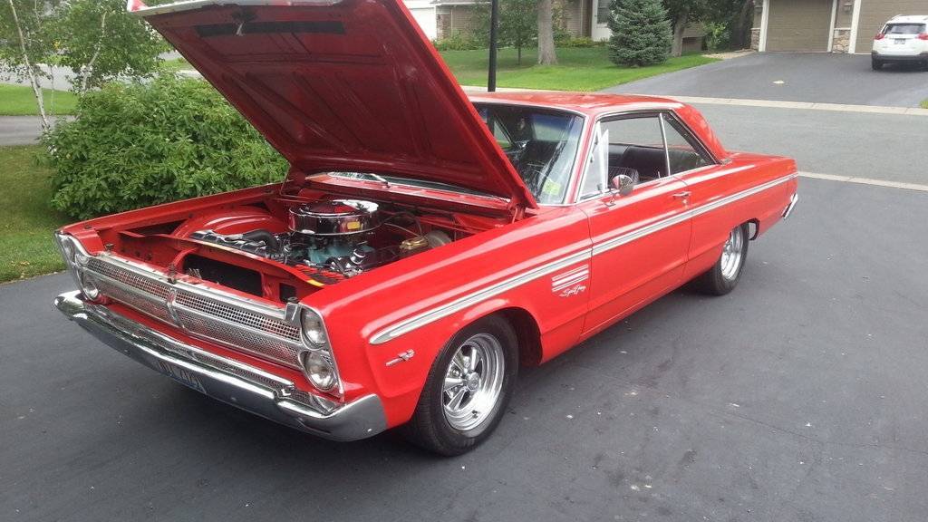

1965 426 Sport Fury. Started/drove it every few weeks until about this time last summer when I parked it in the garage for a full interior re-do. Actually started it occasionally through the winter, although didn't drive it. It has sat off since about March, made sure there was a full tank of gas. Interior is pretty much finished, charged the battery today, turns over fine, just won't fire. Worried if I crank too long, the starter motor will fry. Thoughts?

Like was said above, basics, spark and fuel. We could help more if we see some pic's of the car:D

Thanks guys. Cleaned the points and cap terminals (they were pretty corroded), threw some gas down the carb, and about 10 seconds later it started.
:wideyed: Sharp car, one of the most desirable as far a 65 Sport Fury's go. Just don't tell me it's a 4-speed.

Yep, 4 speed. Has original block still, but Edelbrock heads and intake and carb. PS and PB. I don't know the rear end, but it hums at about 3200 rpm at 60mph. Was a magazine article car back in 2000. Has been sitting for a while when I got it 2015. Slowly freshening it up, interior this summer. Over the winter going to get the engine re-done, it sounds like it has solid lifters, but it doesn't. The guys at Sharadon Performance in Hugo, MN, think it has the wrong size rings in it and the pistons are flopping around. That can't be good....
