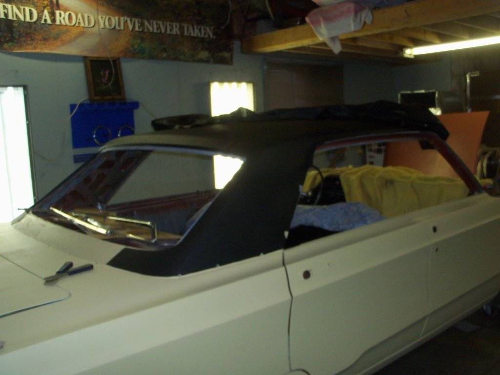

Now on Frankie, our 69 F3, the windshield stayed put, but I had the rear window,all garnish trim, and all side trim and weatherstripping removed. Both headliner and vinyl top were done.
