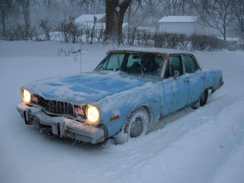

It is absolutely doable. I'm up by Lansing, and daily drove a '74 Dart from the Fall of 2007 until this past Spring.
Do go into this assuming that the rust is going to kill it eventually. Undercoating and such may help but sooner or later you will have a parts car, so don't pick something too nice to start with.
My understanding is that any of the disc brake options will need 15" wheels (considering the options for 14" tires these days, probably a good move anyway)
Electronic ignition is probably a good upgrade, but I'm not sure I'd bother with the fuel pump.
