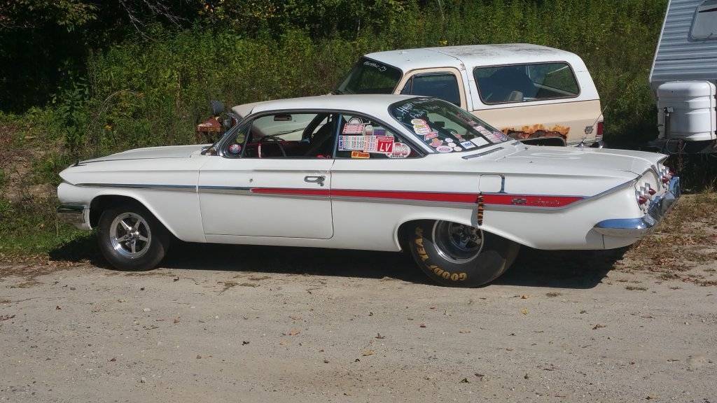

Interesting . I don't do big jobs on my Fury or any car much anymore and my mechanic said the same thing when I asked about installing a suregrip. He said the car is better off without it. He was semi reluctant to the idea of 3.55 rear end too but said he would do it if I really wanted to but recommended without a SG. He said the car is new to you ,drive it ,fix stuff ,get used to it and see. I took it on the highway for the first time after I bought it and was glad the engine wasn't spinning any faster than it was at 75 mph. It has 3.23 rear with open diff. I'm not changing a thing. It is a 19 foot big block cruiser after all not a wanna be stop light racer. My opinion only. My mechanic is a drag racer. Here is his car. [engine pulled for rebuild]
Interesting . I don't do big jobs on my Fury or any car much anymore and my mechanic said the same thing when I asked about installing a suregrip. He said the car is better off without it. He was semi reluctant to the idea of 3.55 rear end too but said he would do it if I really wanted to but recommended without a SG. He said the car is new to you ,drive it ,fix stuff ,get used to it and see. I took it on the highway for the first time after I bought it and was glad the engine wasn't spinning any faster than it was at 75 mph. It has 3.23 rear with open diff. I'm not changing a thing. It is a 19 foot big block cruiser after all not a wanna be stop light racer. My opinion only. My mechanic is a drag racer. Here is his car. [engine pulled for rebuild]View attachment 109818
I agree 100% about yer mechanic's sure grip comment. I'm running 3.23s in both of my '66s. Also, I really like his bubble-top '61 Impala.
