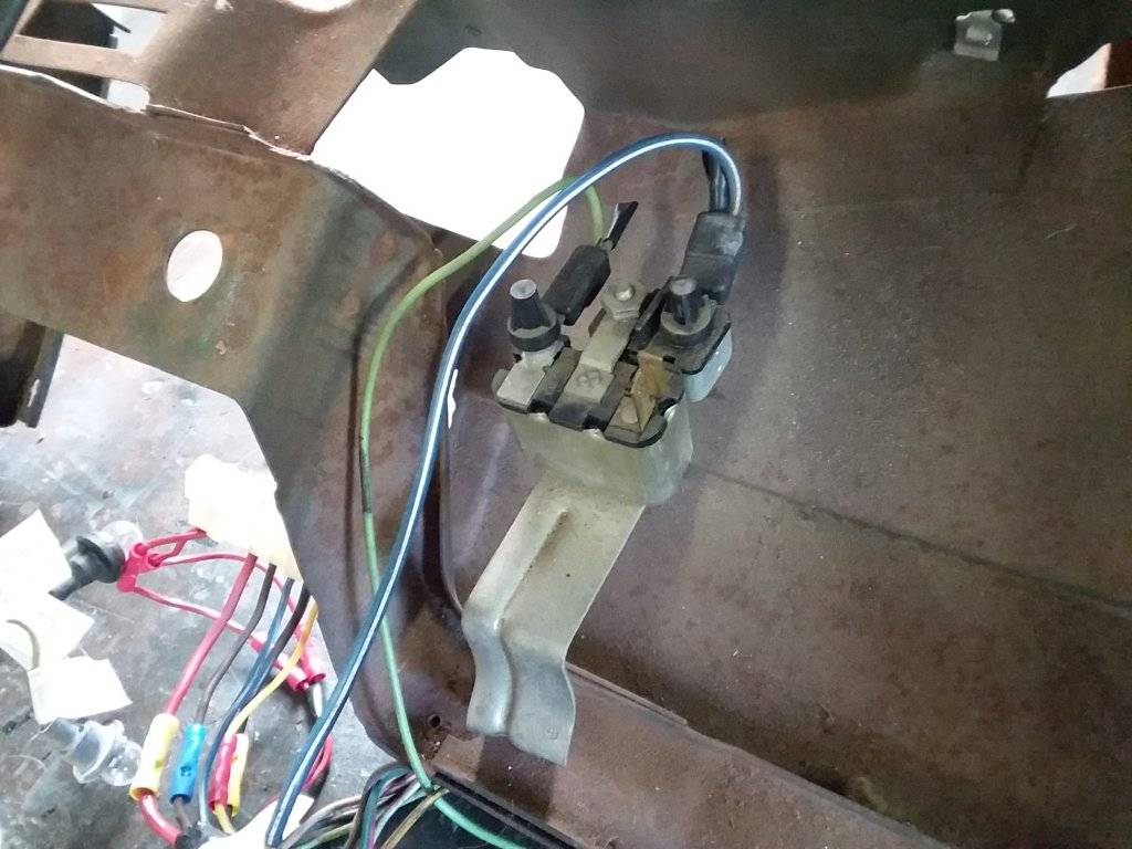

I agree with the clicking being the relay and the relay being OK. My 1970 does that sometimes when headlights are on but ignition is off, so HL doors can't open.
I'm curious about the relay returning ground during close thru the light filaments. My relay is installed on the dash shell. I thought it grounded through the shell. Thanks!
It took me a long time to figure that one out... Some time with the FSM etc.
What happens is if a bulb goes out, the headlight doors won't close. I went through this when I added relays to the lights. The relay isolated the headlights, and therefore the ground return, to the relay.
Thanks. What a strange ground path for closing the HL doors!
When you think about it, it makes sense as a safety feature. It tells you a headlight is out and even makes it a little easier to change the bulb.
I don't recall seeing it in any literature or manuals though. It's probably mentioned somewhere.
