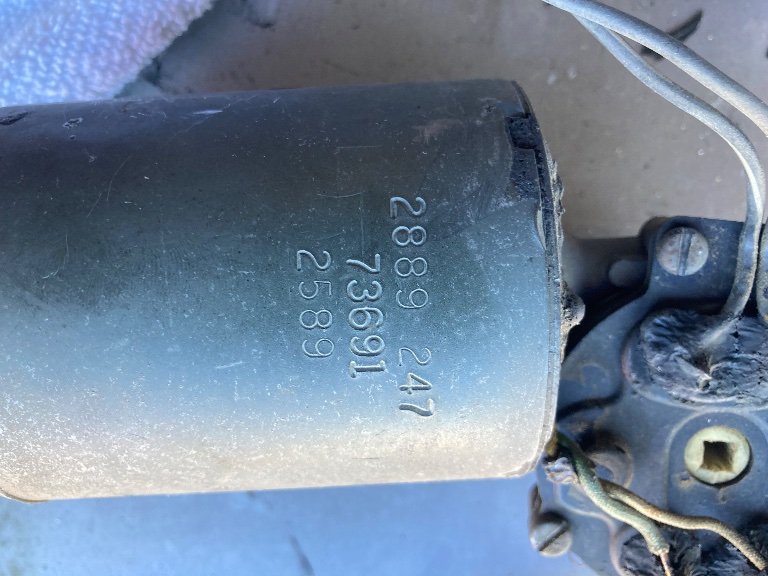

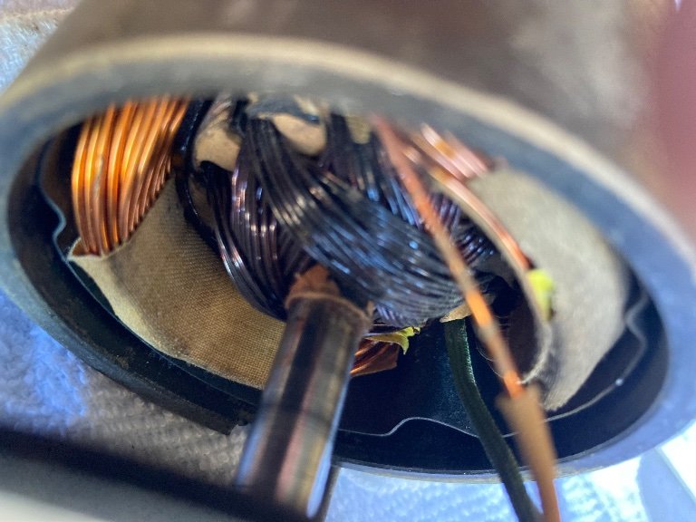

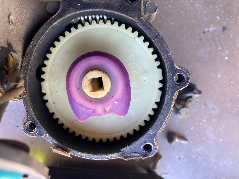

Working on my 68 300, got my horns working again, after replacing both horns, now removed headlight motor. I cannot get the 2 screws on the body loose! I did pull end caps as far as I could, looks like inner windings are burned up. Are there after market motors out there or can these be rebuilt? The gears looked in real good shape.
If you mean the 2 screws holding the magnets in, don't even try. The only way I've seen those removed is with a screwdriver bit being pushed down with an arbor press so the bit stays in the screw. Then the bit has to have a handle on it for leverage.
In other words, they really aren't intended to ever come out.
That makes sense to me! I gently held the motor in my vise for leverge and they didnt budge! Do windings look burned?, the insulation is also crispy crumbly. Hopefully I can locate another motor.
