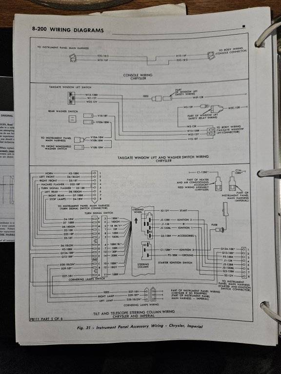

Im restoring my 71 new yorker and now installing the wires. There are 2 wires ( both black with white stripes that go to the Heater and A/C accessory feed (see attached diagram.) My new yorker has the tilt/teloscopic steering wheel and as such it has the separate wire with a bilt in fuse. This is the wire the book says should b used. With a std steering wheel the feed wire goes to the fuse box (heater A/C fuse.)
My new yorker has both feed wires. I dont understand the reasoning behind this. Wire experts fill me in.

View attachment 736136t
