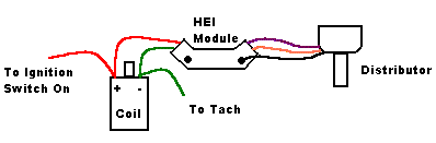

Assuming you are talking about the GM HEI, and not something else... The GM HEI module and a Chrysler electronic distributor is a combo that's hard to beat. The HEI is cheap and reliable and gives great
performance.
Some reading: HEI electronic ignition discussion - Slant Six Forum HEI Electronic Ignition Retrofit How-To - Slant Six Forum

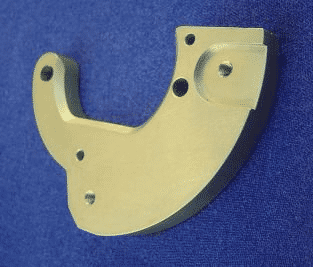

If I were to do this, I would buy a rebuilt electronic distributor from @halifaxhops and then you can use a few different mounting solutions for the module. Even just screwing it to the firewall works, but there is a nice little bracket available that just bolts to the distributor.

Great bracket for the Hei mod remember to use a .3 ohm coil. I like the Petronixs III since it looks stock. Also match the curve in the distributor to the 383
performance.

I did this at no cost using parts I had. I used an aluminum mounting bracket on the core support. The GM modules are dependable but I have had one or two over the years go bad. But the heat and vibration in the distributor probably attributes to that.

I am the person that makes and sells the HEI conversion mounts. http://www.designed2drive.com
They work well bought a bunch from you a few months ago.
