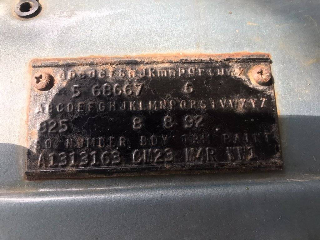

It’s highly likely that’s the original vin tag for your car.
I think you’re right the VIN tag is likely original but the fender tag isn’t. A lot can happen in 57 years. I was able to see the sellers package that shows the history back to 1973 . There were a total of 3 owners with the latest having owned it for 34 years.

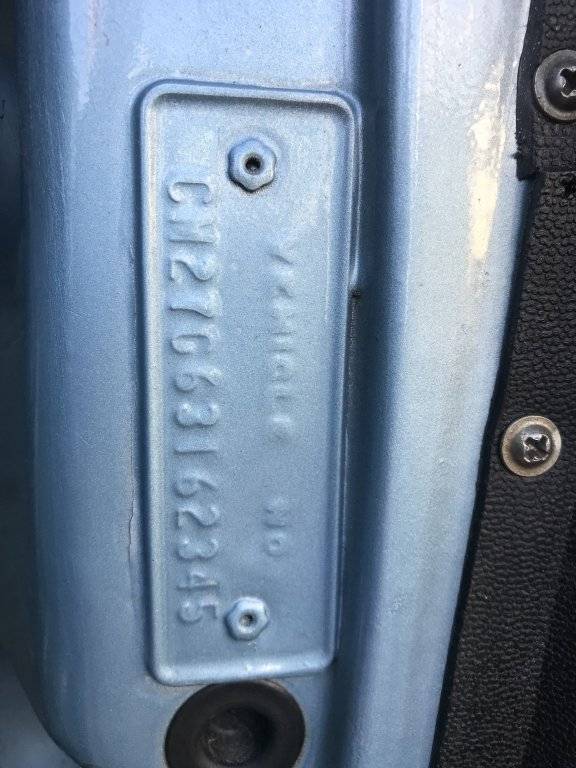

I got the VIN decoding from here:
For '66 they don't show what the first 2 digits (CM) decode for. Presumably C is Chrysler, but the M for Series is unlisted.
Everything I've read about C-body convertibles from the 1960's is that they were all made in Windsor.
The VIN number you provided matches the car better.
Model Year:​
1966
Model:​
Chrysler Newport/300/New Yorker
Body Style:​
Convertible
Price Style:​
Medium
Engine:​
383cid 2bbl
Assembly Plant:​
Jefferson, Michigan
Consecutive Unit Number:​
162345

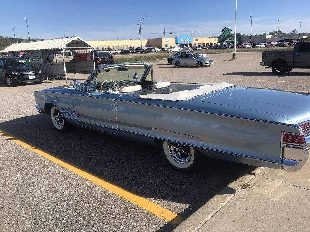

The car is in amazing shape underneath and rides very good with absolutely no squeaks or rattles.

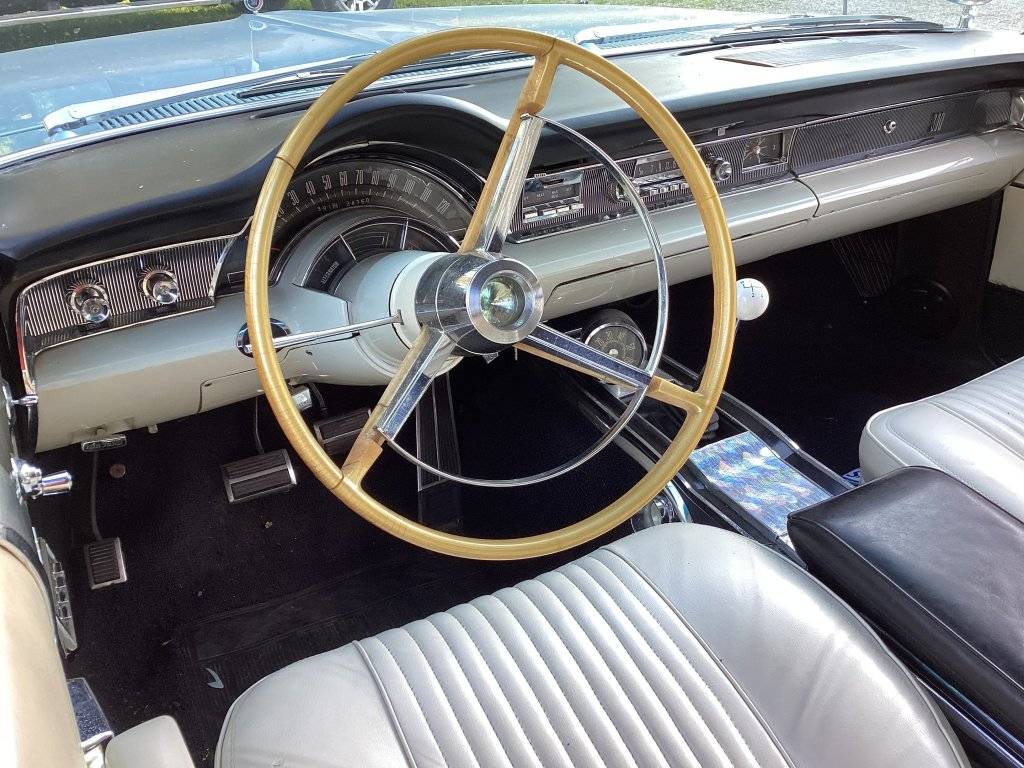

The 383 has a 670 Holley which suits the engine good it has stainless steel duals with just enough rumble that an American V-8 should have. The 4 speed shifts excellent it’s a close ratio with at least 3:55 gears I would guess because it’s turning 3000 at 60 mph.
I’m looking at swapping out for a A833 overdrive which will kill 2 birds with one stone. It will give me a lower 1st gear to get the 2 ton machine moving without riding the clutch, that first gear is a 2.44 in the close ratio isn’t as low as I would like the A833 overdrive has the 3.09 1st gear.Tgen once I’m in 4th I’ll be at a .72 -1 to bring those revs down from 3000 to 2200 at 60 mph.
I think that's actually a conversion from a manual 3-speed. To my knowledge there's never been a documented Chrysler 4-speed in 1966, Plymouths & Dodges yes, but for some reason the Chryslers were omitted. The service & parts books also support this. It doesn't particularly make sense as 4-speeds came in a decent number of 65s & a handful of 67 Chryslers. Also the 3-speed could be had with the 383-2V but the 4-speed always came with the performance versions of the 383 & 413/440 on C-bodies. Since there's no corresponding fender tag for the car, another option would be to contact Chrysler Historical. They used to give a lot of vehicle detail but my understanding is that they only supply IBM punch cards now but that could be a conclusive way to determine the actual options. Regardless, it's a super nice car. It has the 65-only Hurst shifter with console which is the nicest of the bunch.

If it's turning 3000 at 60 then it likely has something like 3.90 or 4.10 gears. The OD trans with the 3.09 1st came in economy A's which had a short tailshaft & would not fit a C-body. It also takes a special shifter & there were longevity issues with it, especially with the aluminum case. It's highly likely your trans has the 2.66 1st gear, not 2.44. The best & most cost-effective solution may be to just swap to 3.23 gears. It gives decent all-around performance.
Yes, I did a bit of research and found the 66 had the 3 on the tree as the manual transmission available. I did talk to a few old Mopar guys and they told me they knew of a few workers that told stories of cars that were being built in the factory FOR workers OF the factory that were slipping through equipped with parts that weren’t offered as official options. My first thought when I acquired the car was that there were parts for the 4 speed on it from a 65. I had a friend of mine that worked at a Mister Transmission for decades look at it and swears it’s factory. Regardless of how it ended up having a 4 speed in it, I’m glad it’s there. Whether it was factory or not wouldn’t have changed my mind of buying it either way. I’m more of a guy that enjoys driving the cars like they were intended to do. I know a lot of people are into documentation, pedigree and matching numbers stuff and that’s okay but I’m not one of them.
