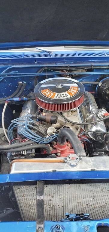

I appreciate that so good to know. My big question was more what headers to get and what's fits? Like can I do long tube headers cause looking at the engine it seems tight on the drivers side for anything

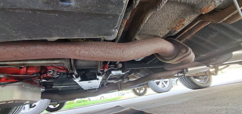

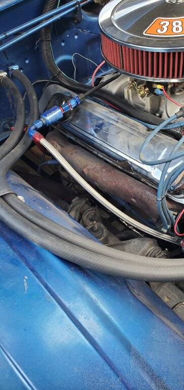

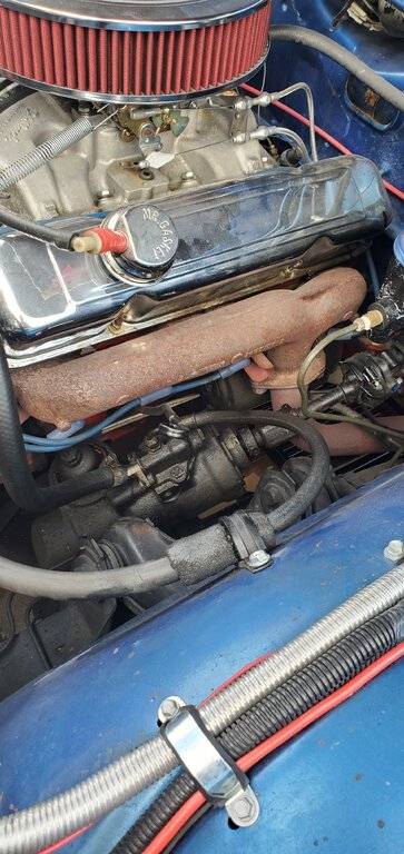

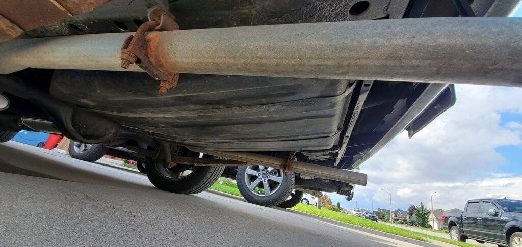

So took some pics ill post in a second but did some rough measurements and the pipes seem to be roughly 2.5 before current muffler and basically the same at the rear tips the measurements being external size and very roughly measured
There's a few pics
My buddy who's a mechanic and me had it up the other day on the hoist and he seemed to think that the way the exhaust was was costing me some horse power amd I should open it up more.

Looks like factory pipes to the mufflers, which are not OEM nor the tail pipes. As I recall, the OEM pipes are 2.25" ID, which is fine. If the mufflers are the same in and out, then you've already got a decent system. Provided the mufflers are decent. The referenced Walkers are good, but look-a-likes might not be. Plenty of capacity for a 383 or 440, even with some upgrades.
In one respect, if you look at the power coming out of modern V-8 (engines with single exhausts (or single exhaust, dual outlet systems with 2" exit pipes), even the dual 2.5 pipes on a reasonably stock engine are a bit of overkill.
Get the tail pipes "fixed" with a correct end configuration and you'll be fine.

Headers over time tend to be problematic. I would keep an eye out for some HP manifolds. Cheaper than headers, last a long time and are factree. And factree pipes still bolt right up.
On my 65 383 Sport Fury I used some manifolds off a 70 440 Charger R/T and it all fit like a glove.
