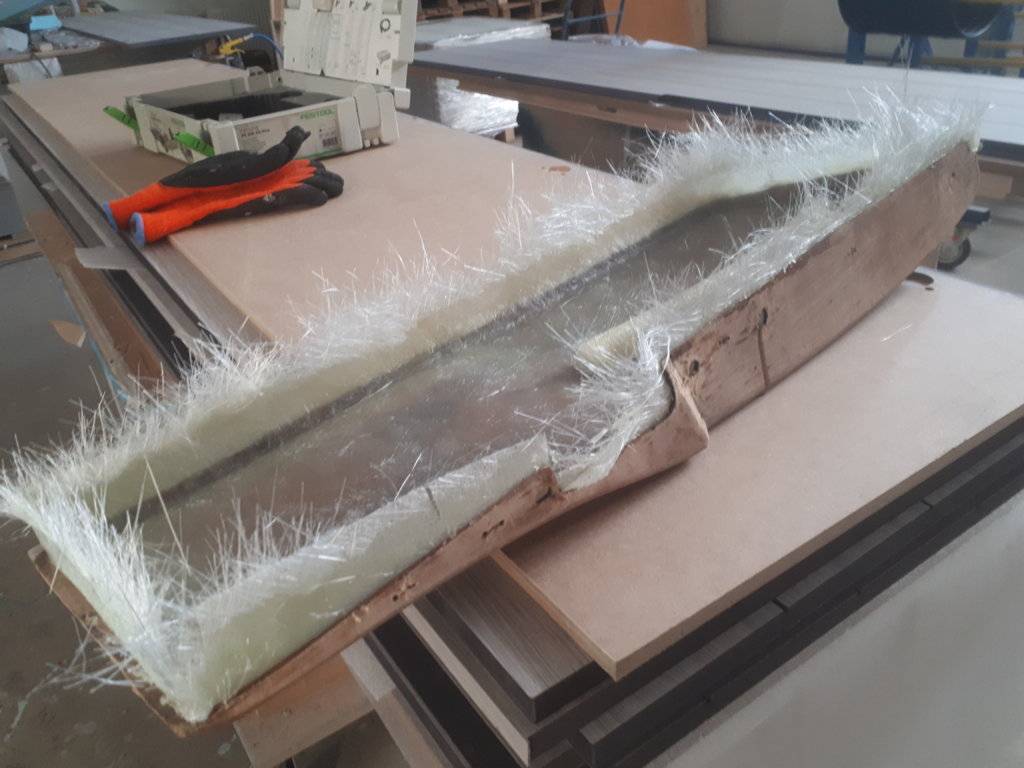

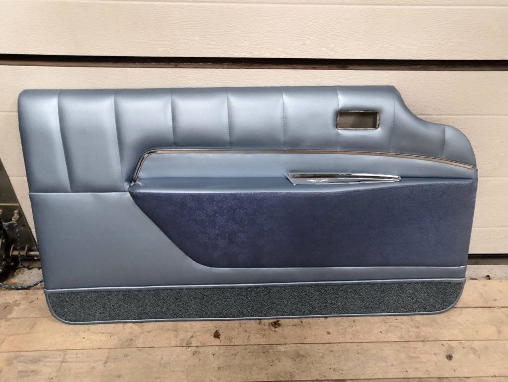

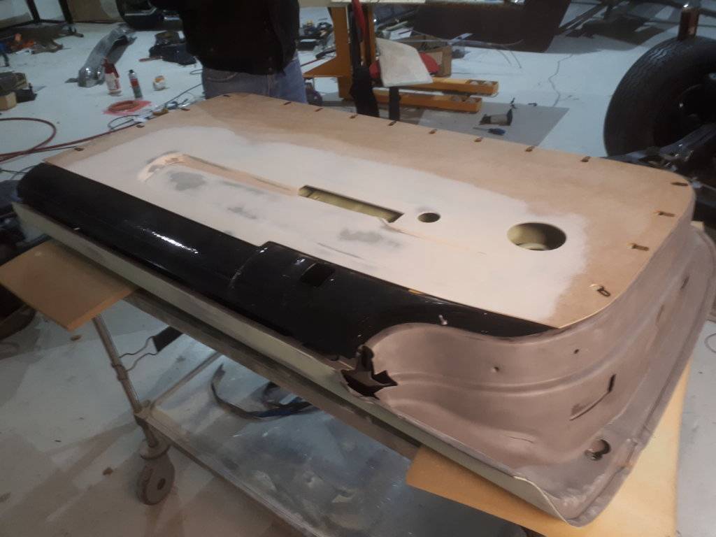

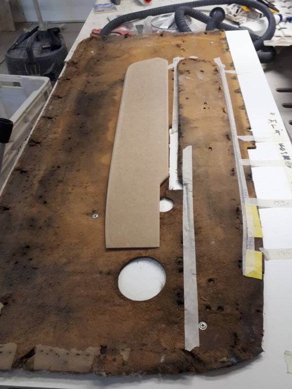

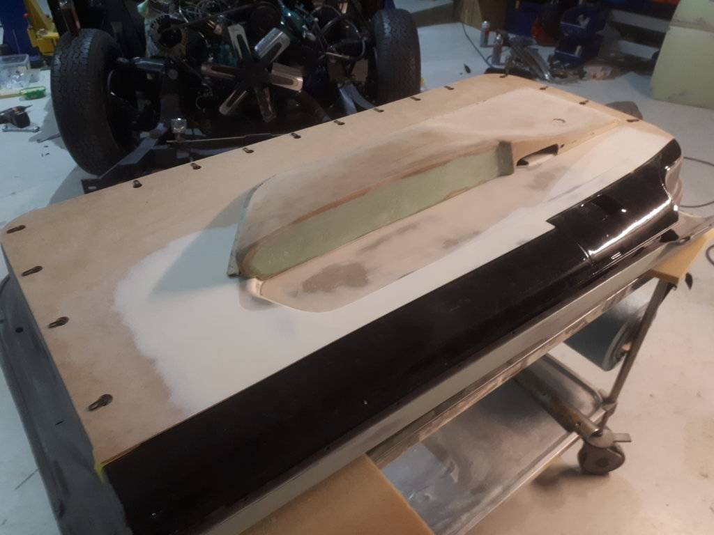

I'm working on new door panels. Old ones was in bad shape, only hand support pieces are somehow usefully after support and reshaping with glass fiber.
At the top of the panel there is an embossment made of glass fiber and laminated together with another panel.
Starting point...

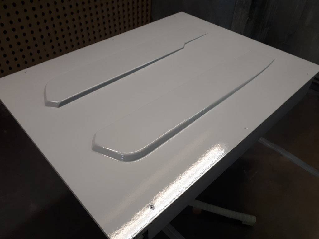

model for glass fiber mold
some clear coat PU lacquer
result...
Testing, final sanding and few coats of PU lacquer before vinyl.
Starting point...
