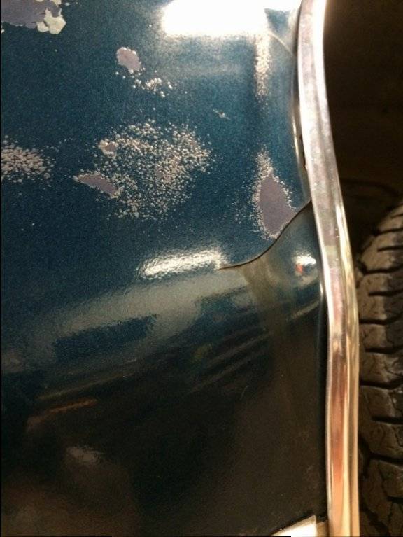

How bad/what is this

Why is this paint cracked? Is this bad bodywork coming back, the result of an accident, or? I don't have much/any experience in this area. Thanks
Agreed. There's rust doing its thing behind that old bonds job.
It did not take the jury long to decide, the votes are all in and my fears are confirmed! Thank you to all!
You're in Maine, what do you expect???
The story is... It started life as a "California car", after the original owner died his nephew got it, moved it to Iowa where it has been in storage for several years. I was hoping for better. All-in-all more body work than I want to deal with.
If that is the only bad spot you got it better than many. Can we see the rest of the car?

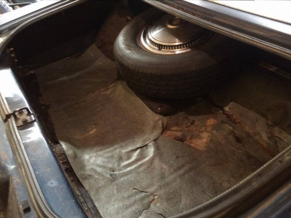

I have not seen it in person, only pics. I asked for a picture of the trunk, under the vinyl mat, this was all he had...looks like it has been wet. strike two. 3 1/2 hr. drive one way, I already have a car on which to practice rust repair, etc. I think I'm gonna pass.
