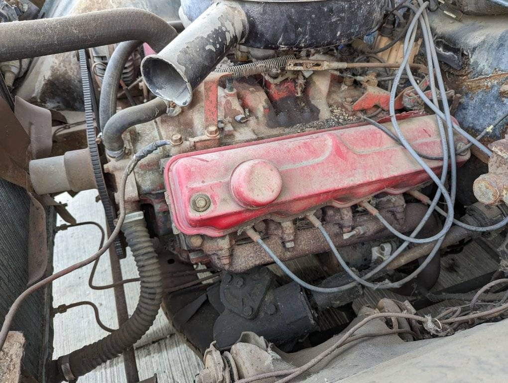

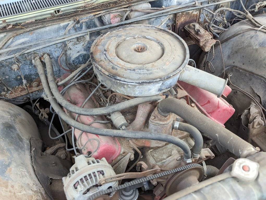

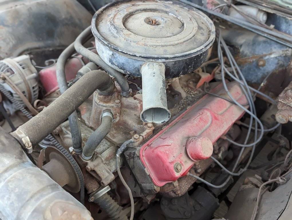

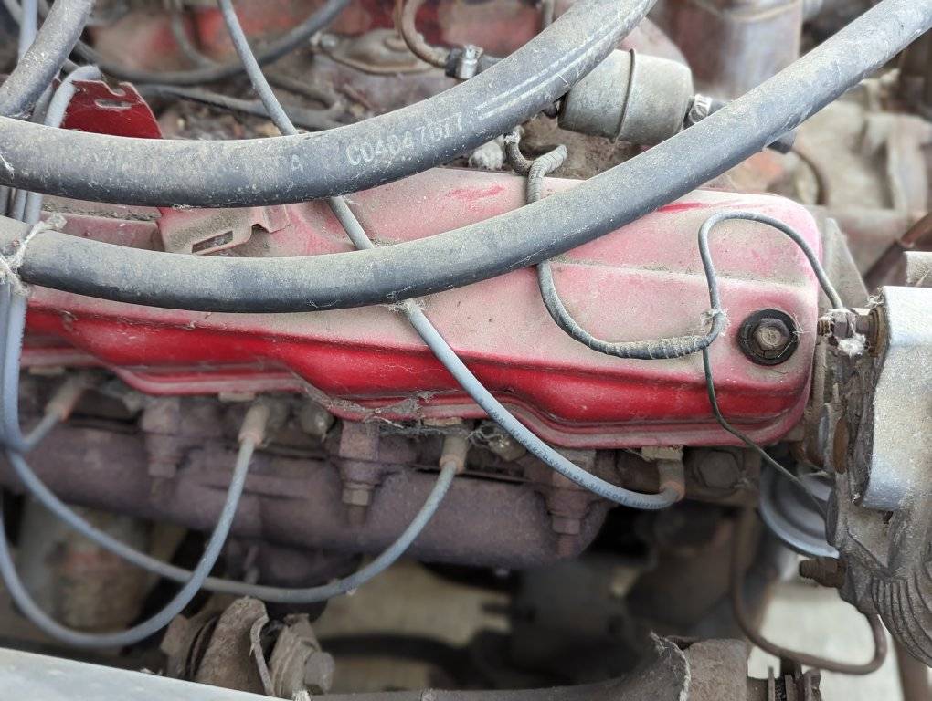

Here is the engine. Polysphere 318?Do the valve covers look like this? If so you have a Poly 318 and not a LA. It doesn't matter really. Just curious.
Yes, Poly 318. Those are good engines. You can do a compression test but like someone may have mentioned, if the engine hasn't ran for a while the test results may be low and inconsistent. Get it running on all 8 cylinders and drive it for a thousand miles or so. Then your test results will be more correct.Here is the engine. Polysphere 318?
Here's what I think the plan is going to be:Yes, Poly 318. Those are good engines. You can do a compression test but like someone may have mentioned, if the engine hasn't ran for a while the test results may be low and inconsistent. Get it running on all 8 cylinders and drive it for a thousand miles or so. Then your test results will be more correct.
