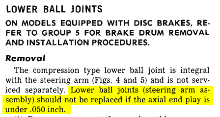

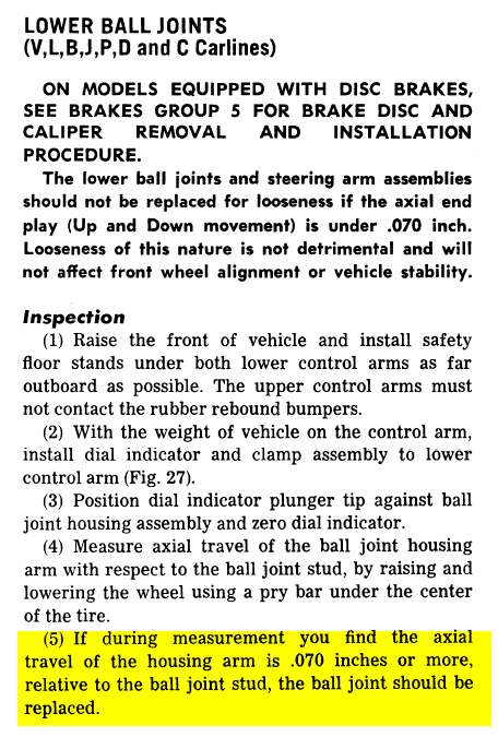

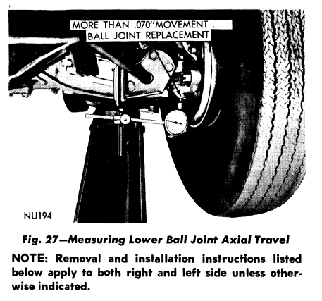

here is what I found...
The first is for the 66 Polara/Monaco
The second is for the 73 Newport.
