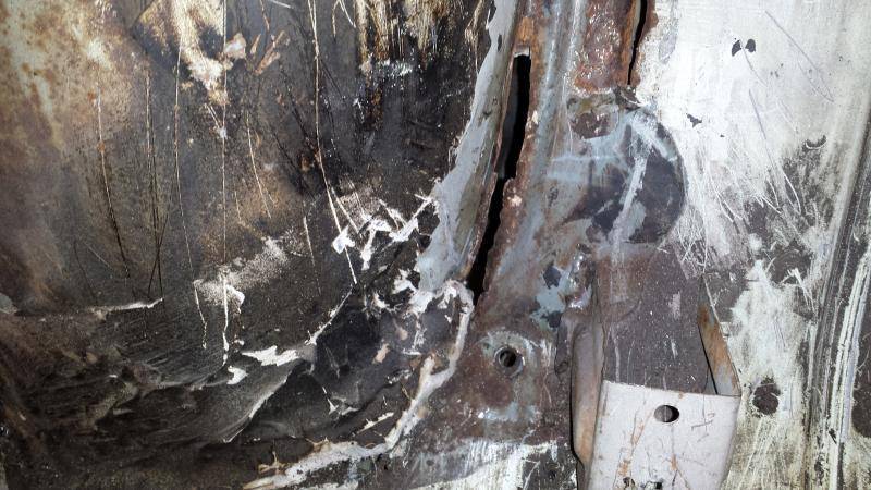

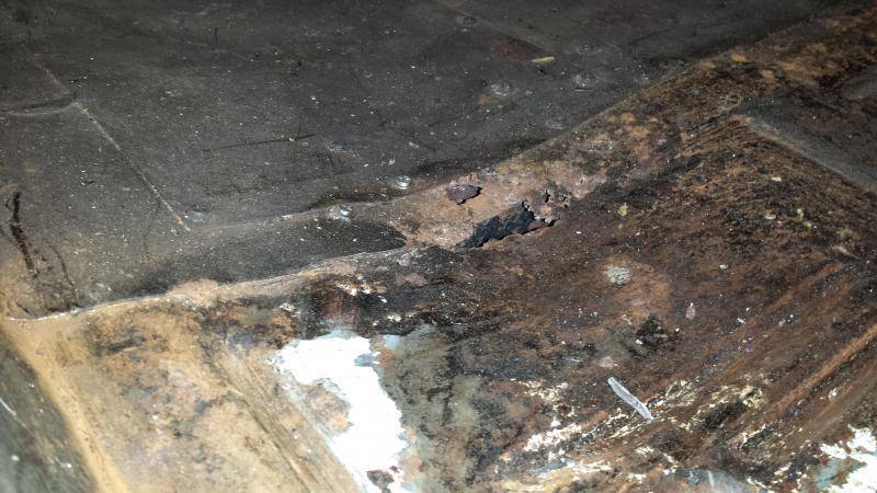

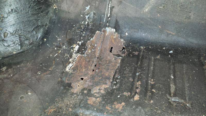

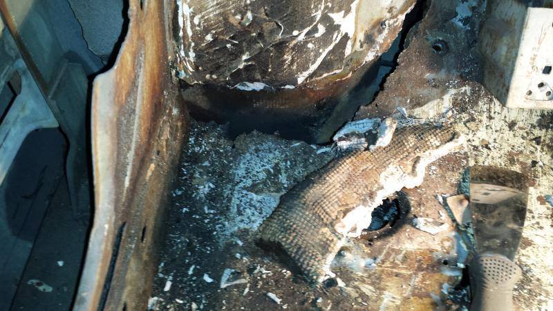

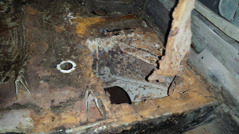

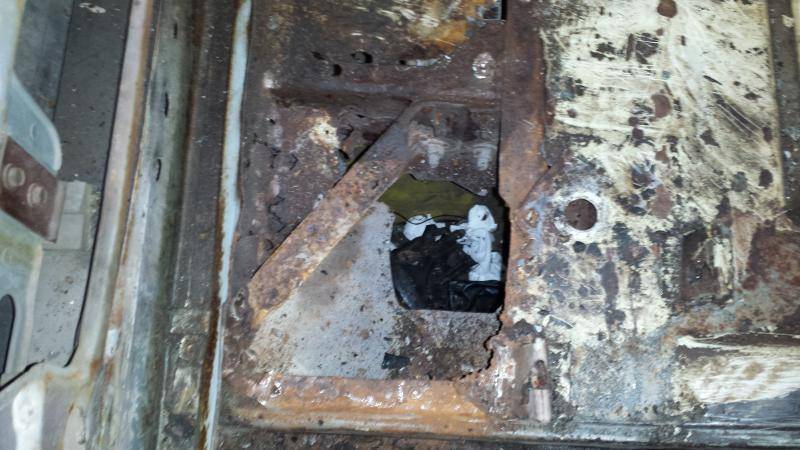

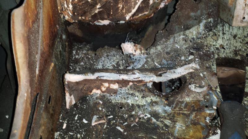

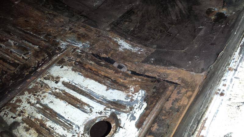

Have a look at what I have found to date..
I love when bondo & fiberglass mesh are used for structural repairs..
Caution, it is not for the faint of heart...:icon_pale: :icon_pale: :icon_pale:
Here are some shots of the trunk area plus one ofthe other side inside passenger area
