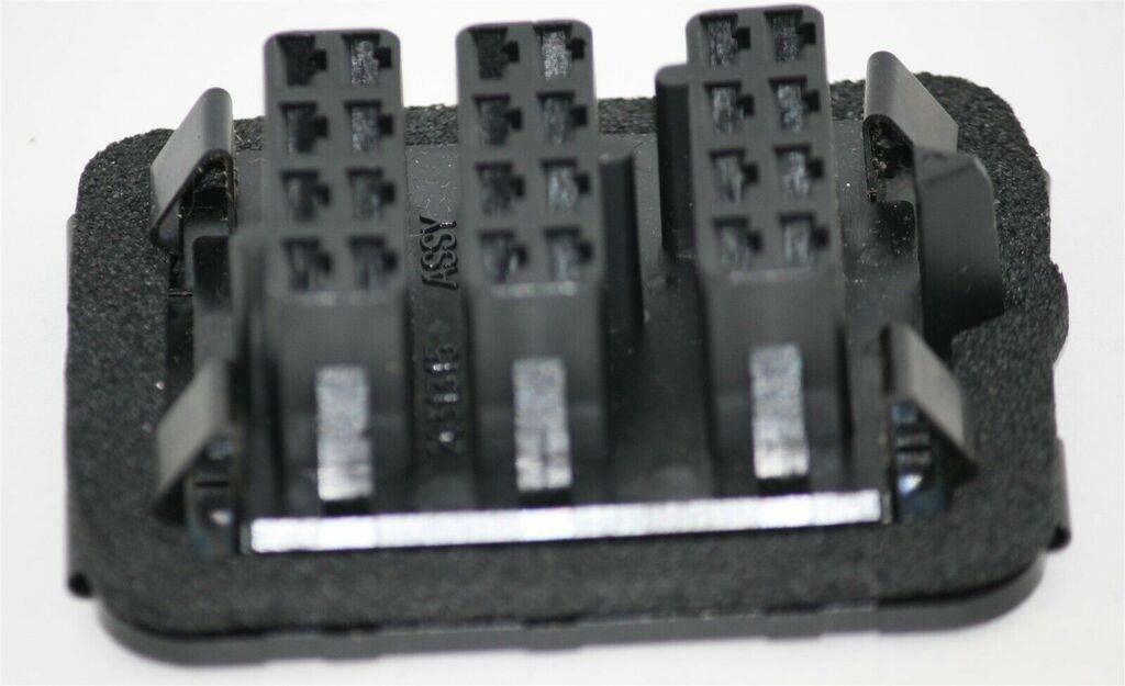

I cannot find where the FSM describes how to remove the bulkhead connector on my 78 Magnum. The illustration in the FSM seems to show that there are just a couple of internal clips that hold it on. So before I made a terrible mistake, I thought I would come to the experts to get the inside scoop. Do I just pry it off? Is there a screw or bolt I didn't see? Yes, the negative battery terminal is disconnected. Thank you...
If it's anything like the ones in 60s C bodies, you depress the clips from the engine side of the firewall and push the bulkhead connector into the interior. Only need to depress the clips on one side. Remove the various harness clips from the bulkhead first.
However, that's for 60s C bodies - it may be totally different for a Magnum...
These clips
